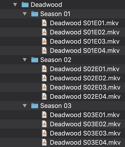

Often these issues are due to either the TV show folder naming or the organization of the seasons and episode files. Could you do a screen cap of the file organization for the Superstore files?
Also it often helps to have the seasons in their own folders inside the TV show folder.
Here’s an example for the TV show “Deadwood”

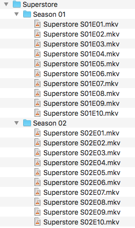

Okay, let’s see if this helps. Organize your files and name them like this
Superstore File Structure and names
This should let Infuse fetch the artwork for the TV show folder after you open it in Infuse.
Now if you want to provide the TV show poster place the artwork in the TV show folder and name it “poster.jpg” like this
Superstore with poster
If “poster.jpg” doesn’t work try “folder.jpg”
Also, how are you connected to your NAS? Are you using SMB, FTP, DLNA, UPnP, etc?
I changed the names of each episodes to the example you gave me above.
That worked!
