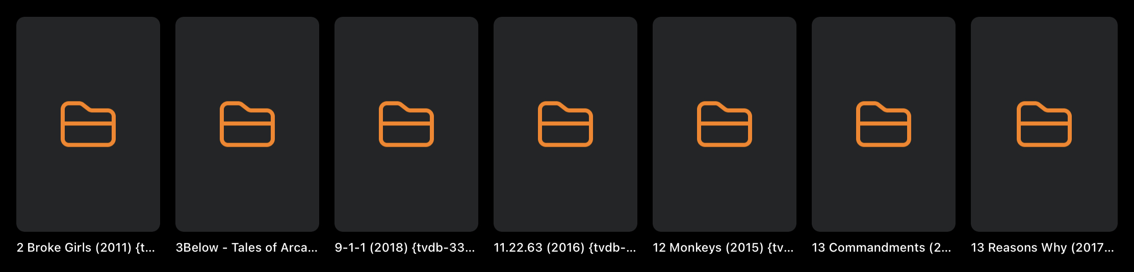

I have started to update my folder naming convention to follow the plex recommendation and use as format : {Series TitleYear} {tvdb-{TvdbId}}. However, using this convention, the match seems to no more work as all shows with this Show folder are not updated with the expected poster and metadata.

Mapping seems not to work. Other folder with just the name have correct picture. Inside a folder, serie can be detected and metadata downloaded.

I remove the “additional plex info” for 2 Broke Girls to test and the poster is displayed immediately. With the tmdb/tvdb id in folder name, infuse can match the show by displaying metadata, season poster … but leave the show poster without picture as a missing match.

If you’re browsing via folder view, there is limited support for displaying artwork on related folders.
If this is something you plan to do, I would recommend organizing things into folders by series and season.
EG
2 Broke Girls/Season 1/episode files
Doing this should allow Infuse to automatically add artwork for the series and season items.
