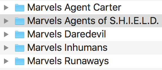

Hello, I’ve tried for days to rename a folder in many, many ways to get it recognised for the metadata but I haven’t found a solution.
Please look at the screenshots of how it must be named and how Infuse see it.
I think because Infuse see a ? at the end instead of period it’s not recognised.
Do you have any suggestion ?

Here is the folder name that is working without a hitch for me
Marvels Agents of S.H.I.E.L.D
Here is how the file names are that seem to make it all work.
marvels.agents.of.s.h.i.e.l.d.s01e01
It seems that the period after the D in shield throws things off.
If you go here where it discusses allowable names for files and folders you’ll see where you can’t have a folder with a period as the last character in the name.

Ok I found the solution, I long pressed on the file name of the S01E01 (where I got no result) and then I spell the name with Siri.
Then Agents of Shield appears on the bottom list and I could select it.
Now the metadata is show correctly.
