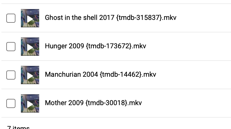

What ID number were you adding to the file names?
The ID numbers are from TMDB…
Ghost in the shell 2017 {tmdb-315837}
Hunger 2009 {tmdb-173672}
Manchurian 2004 {tmdb-14462}
Mother 2009 {tmdb-30018}
Using Infuse Pro 7.7 (4729)

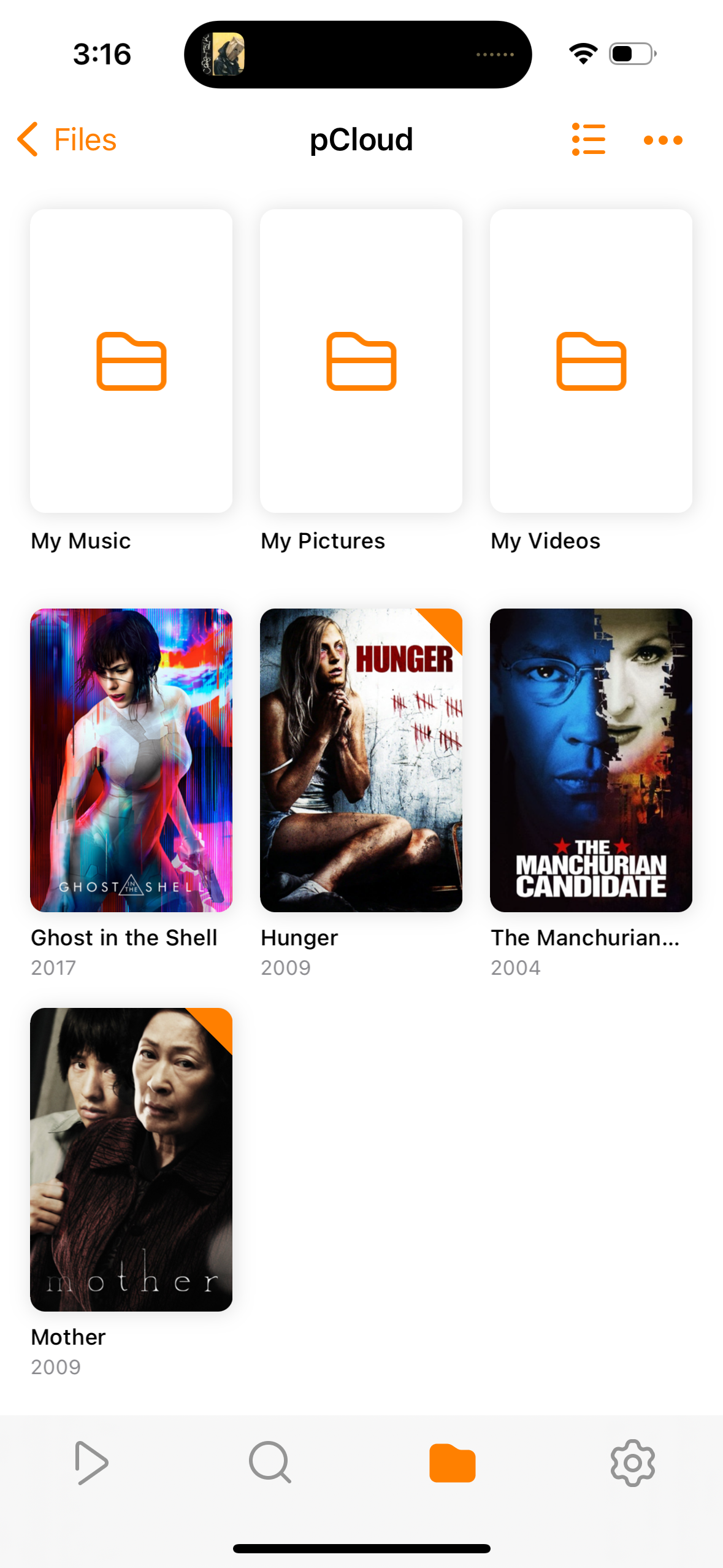

For whatever reason I couldn’t get infuse to read the appended file names.
Metadata fetching is enabled and embedded metadata is disabled.
I did, however, finally find a way to make it work.
I had to delete the files from the cloud. Make infuse scan for changes. Re-add the files and scan for changes again.
This got infuse to read the new file names.
