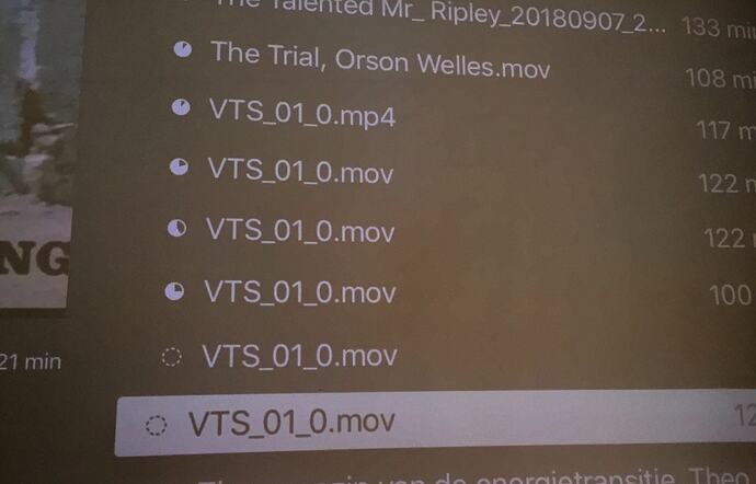

Is it possible to send a screenshot? It might make things clear.
You can, just click on the “Attachments” link when you compose a reply in this thread. It may be easier to just type in the exact name though. Maybe best to do both.
See attachment. (sorry, I didn’t notice)
Five filenames with the same name for five different movies (this alone violates every rule…):
VTS_01_0
When I click and hold, I can change Metadata. Type he real title of the movie. At right the correct name appears. When I click on that name, the result is the same, no change.

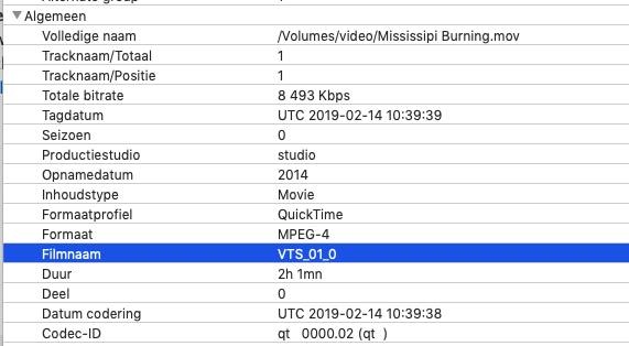

I am not exactly sure about it, but I suspect Infuse is getting the file name in the metadata and not the one in the file system. I would download MediaInfo (from MediaInfo - Download MediaInfo for macOS) and then check with it if those videos have those names embedded in them. If such is the case you should find a way to edit or delete those from the metadata. How to do that I dunno, I never did it.

Got it. Indeed it shows the possible answer:
On top (Volledige naam) the name in the Finder
13 lines below: (Filmnaam) VTS_01_0
I did not find a way to change it.

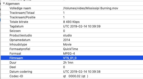

So far, Infuse seems to to be able to change it to the correct file name.
A better attachment
Well, the same mediaInfo’s developer seems to have the tool for you as well: MOV MetaEdit
I didn’t test it. It’s probably better if you make a copy of a video and test it from there. Either delete the “Filename” field or change it to the movie’s real title.
