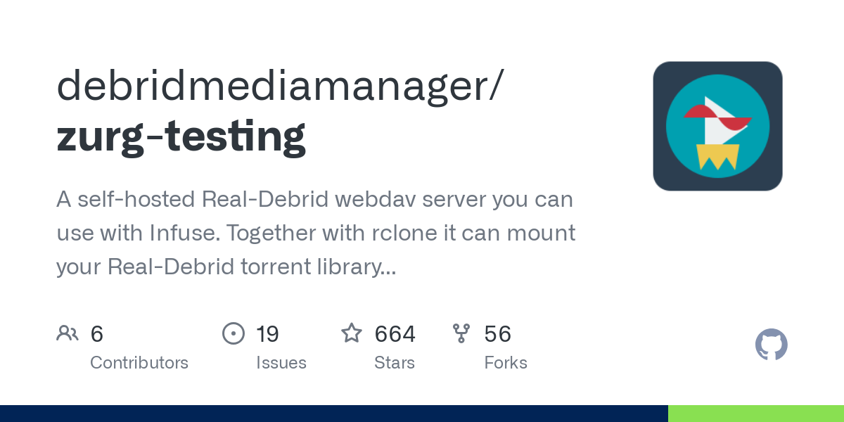

I found this guide which has info specifically for Infuse. I think this would allow you to connect via WebDAV to access these files. Using the strm files would not be necessary.
Also, there are various scanning options available in Infuse for WebDAV (and other) servers and adjusting these settings can affect how fast Infuse is able to index your files.
And that’s exactly what I use, zurg, but with strm instead of mkv. I’ve used it with mkv mounted via rclone but it’s so slow that it was driving me crazy! Sometimes, after pressing play, it would take up to 30 seconds for the movie to start playing! But with strm this no longer happens, it’s much faster and light!
Had you followed those steps before? It seems as though it would allow Zurg to act as a WebDAV server, so you would be having Infuse connect that way instead of SMB. This would allow other devices to connect.
Might be worth a try.
