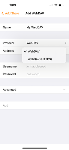

If you are using WebDAV one thing to check is that the WebDAV (HTTPS) option has been selected. This will be required for many external WebDAV servers and attempting to connect via regular WebDAV will not work.
This will be available under the Protocol option when setting up the WebDAV share in Infuse as shown here.
