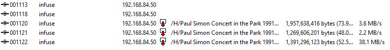

So the way in which Infuse connects to FTP does have some quirks I guess and your problem might be down to it opening too many connections from the same IP. It can open up loads when you seek each time, see my screenshot as I seek once to a new location on this media…
So you can see the numbers, 001113 was just opening Infuse and the sync taking place, 000118 was opening the video and playing from the start but when I seeked to a new location look it opens 3 more.
I would guess maybe that in your server settings for your FTP you might need to open the taps by disabling any IP limit or timeouts or concurrent connections limit etc, just switch all that off.
