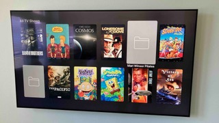

I go to Library, TV Shows, All TV Shows and get a list of my tv shows. One of them is a folder with no picture and is mismatched with the wrong name. I long hold the AppleTV remote to bring up edit metadata and of course there is no match. How do I stop it from matching?

Please see attached. The Pilates is not correctly matched. There is no match in the list, and I can not figure out how to change it. Also How do you select a picture instead of a folder on this screen.

Is this the ‘Pilates’ series you have?
https://thetvdb.com/series/mari-winsor-pilates
It doesn’t look like there are any images for that series, so Infuse won’t be able to fetch anything to display.
However, you can add your own artwork for series, seasons, and episodes. More info on the options for doing this can be found in the metadata.
