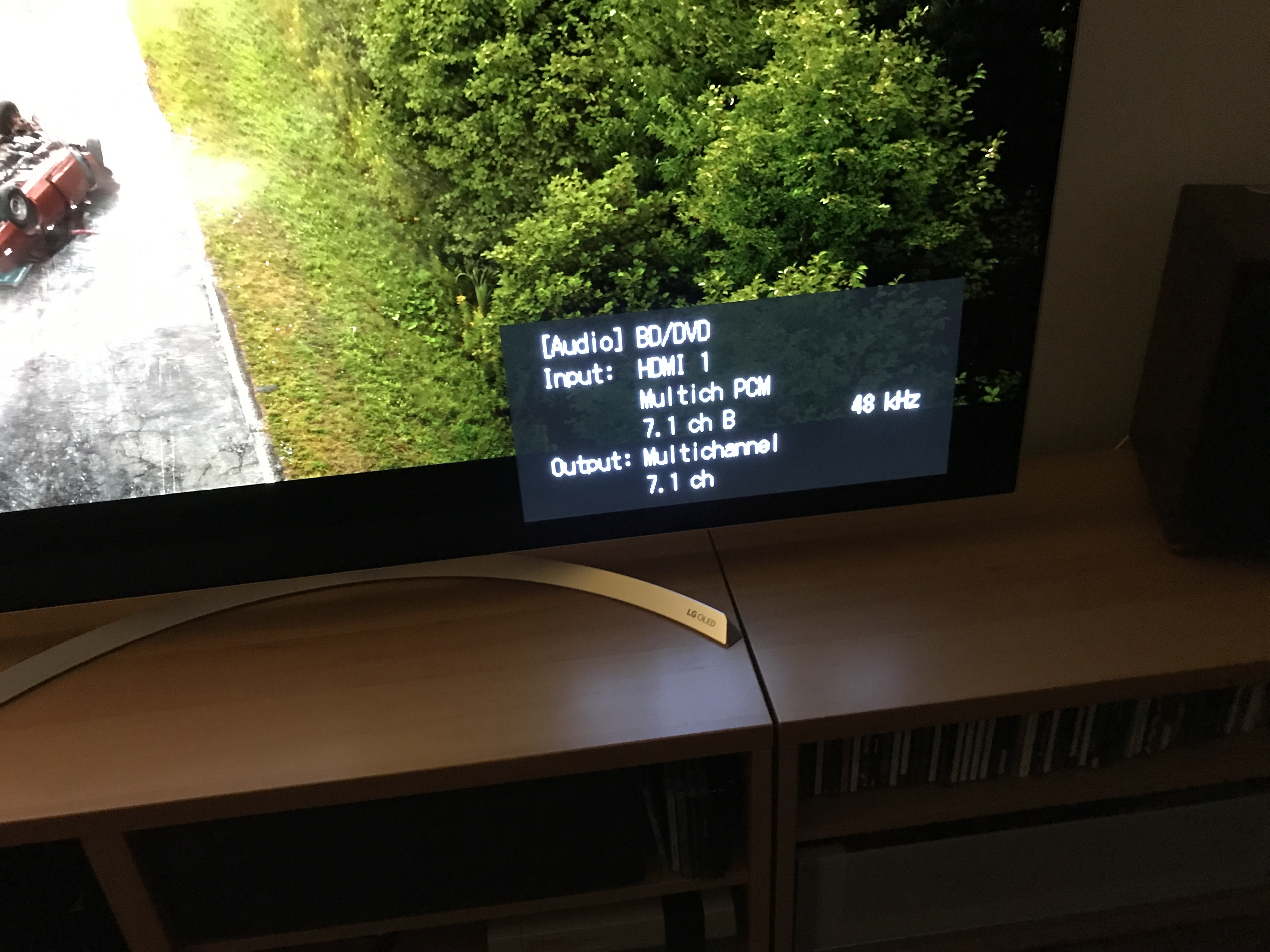

The setings on my receiver is Multichannel and i try Direct Mode is the same sound.
Looks right, but how does it sound?
apple tv 4k can’t passthrough audio signal from video files.
That’s what I suspected.
The settings on my receiver is Multichannel and i try Direct Mode is the same sound.
Direct mode this is wrong mode this is sound without calibration.

I try this and others demos from the same page. In Apple TV is spetacular the image and sound. The onkyo is set at 40 on volume and multichannel pcm. But with Egreat the image is not so good(don’t have Dolby Vision) but the sound is very diferent, deepest and clearest sound than Apple Tv with same volume settings. Only when i set the volume to 50 the sound on Apple TV, with same file, sounds little better.
