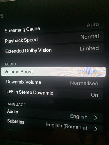

Sorry if this sounds stupid but how do I enable downmixing on ATV? I cannot find where to turn it on anywhere.
Settings, Audio, Downmix?
This is what I have there. I don’t see anything that looks like it should explicitly be turned on or off. Is this option always active now?

Downmixing is enabled automatically when the Apple TV is connected to a device (like a TV) that has just 2 speakers, and does not support multichannel audio.
You can adjust the settings for how downmixing works, but there is no need to enable or disable downmixing itself, since this is all done automatically.
However, the Apple TV itself has a setting where you can force 2.0 stereo output if you want. This can be found in Apple TV > Settings > Video and Audio > Audio Format.
