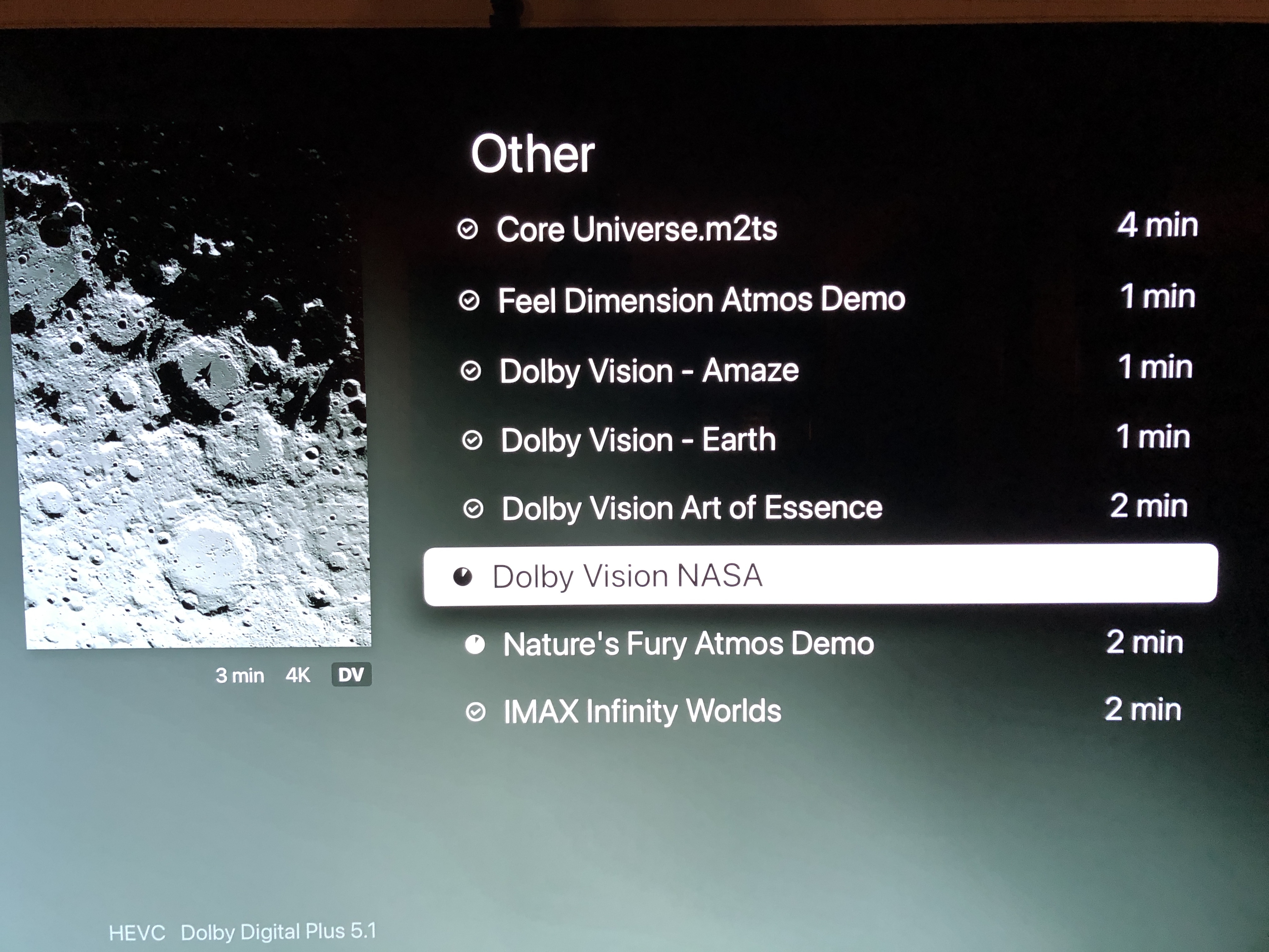

I downloaded a few sample Dolby Vision files from demolandia and Infuse on my ATV4K correctly recognizes them as DV files in the library.

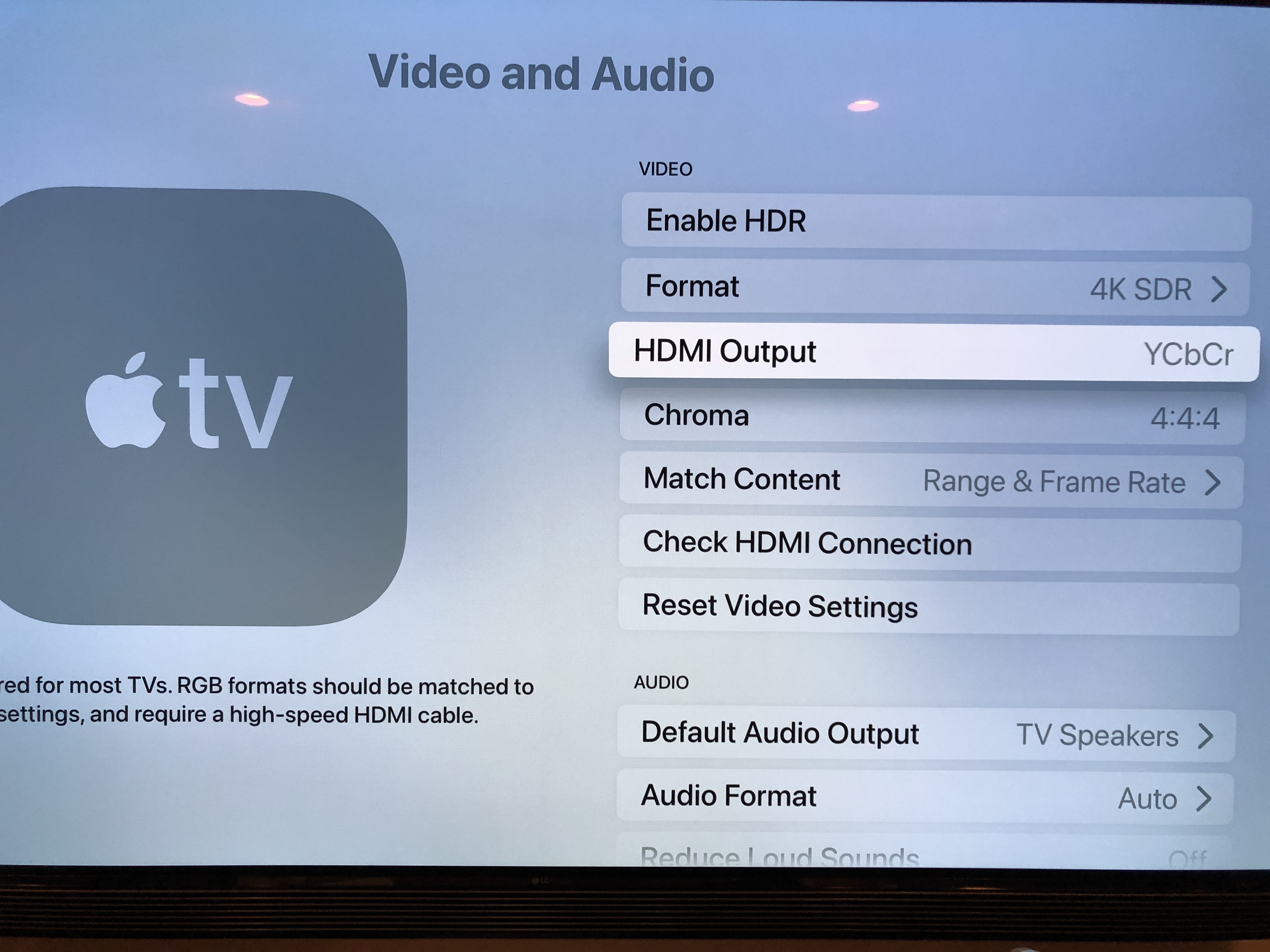

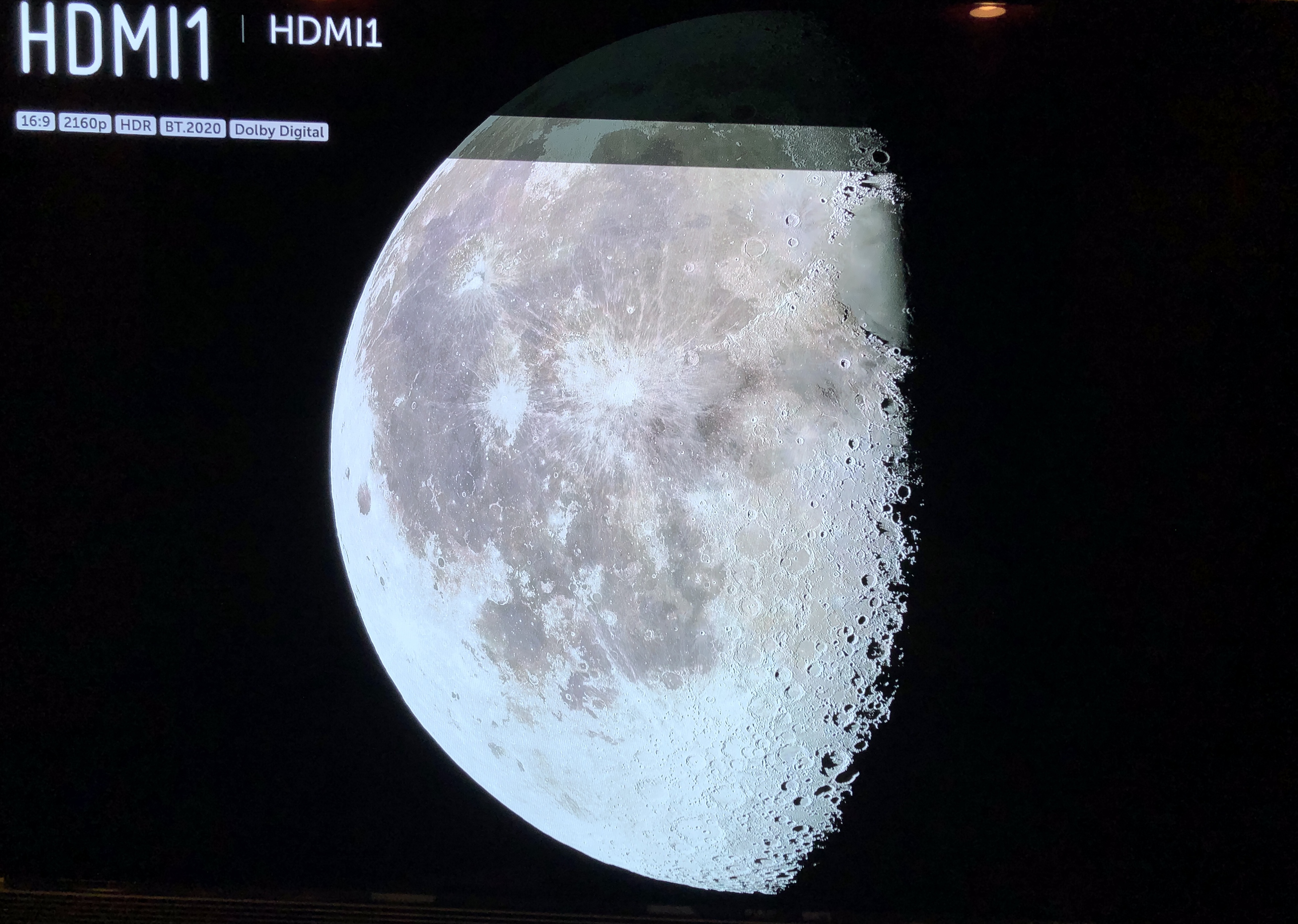

However, when I play them, the HDR icon lights up on TV (LG) and not DV. I have turned on “match content” for both range and frame rate.
If I enable Dolby Vision in Video & Audio setting and disable “match content” for Range then DV works with the TV but I think that’s being upconverted and not true DV. Am I doing something wrong? Thanks for any pointers!

I have almost the same setting, just chroma 4:2:0. Could that cause the issue? BTW, what year is your TV? Mine is 2016 E6.
No luck with 4:4:4. I have an HDMI switch between the ATV and the AVR, and chroma 4:4:4 sometimes creates handshake issues so I keep at 4:2:0

This may be part of it since you don’t see the “Enable Dolby Vision” under the first video option.
The AppleTV only support Dolby vision profile 5 and 8. Does Netflix content playback in DV?
Thanks NC for researching! Yes, I never had the 4k DV 60Hz option. I have 4k 30/25/24Hz DV options as well as 1080p 60/50/30/25/24Hz DV options. Never really bothered since the movies are all around 24Hz but that could be the reason for NASA sample, which is ~60Hz. I’ll try resetting everything tomorrow as well as try connecting directly to the TV and see if I get that option.

The Apple TV also automatically preferences refresh rate over any other setting: if your TV supports 60Hz HDR10 but only 30Hz Dolby Vision (like 2016 LG OLEDs), the Apple TV will pick HDR10, even though HDR10 looks worse than Dolby Vision
So I guess there is no 60Hz support in my TV, which rules out playing the NASA DV video. And the above LG comparison video is 24Hz but profile 4 DV so Infuse can’t play it. Have to find a 24Hz DV sample that is profile 5…

I just wanted to clarify one thing, the samples in the link of the first post specifically the NASA video does play fine and in DV with Infuse so those looking for a DV sample to try this one works well.
