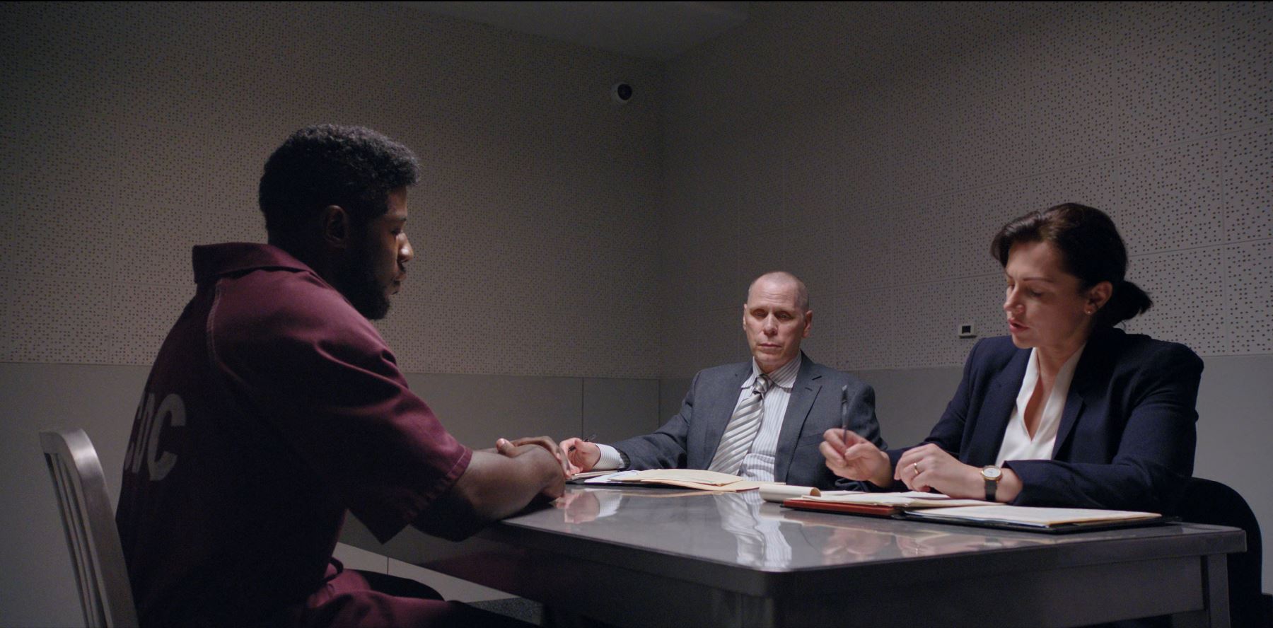

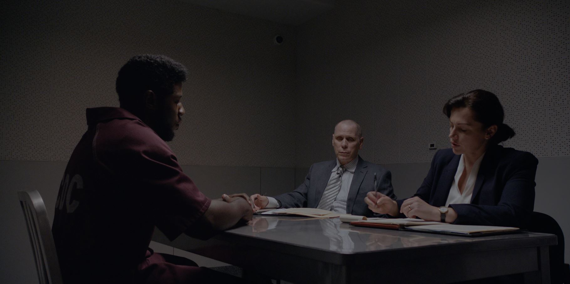

Example of a DV profile 8 file in 4K HDR mode.
Example of a DV profile 8 file in 4K SDR mode.
If forcing SDR output appears correct, but HDR output appears too dark this is likely related to settings on the TV or perhaps an issue with the HDMI cable.
