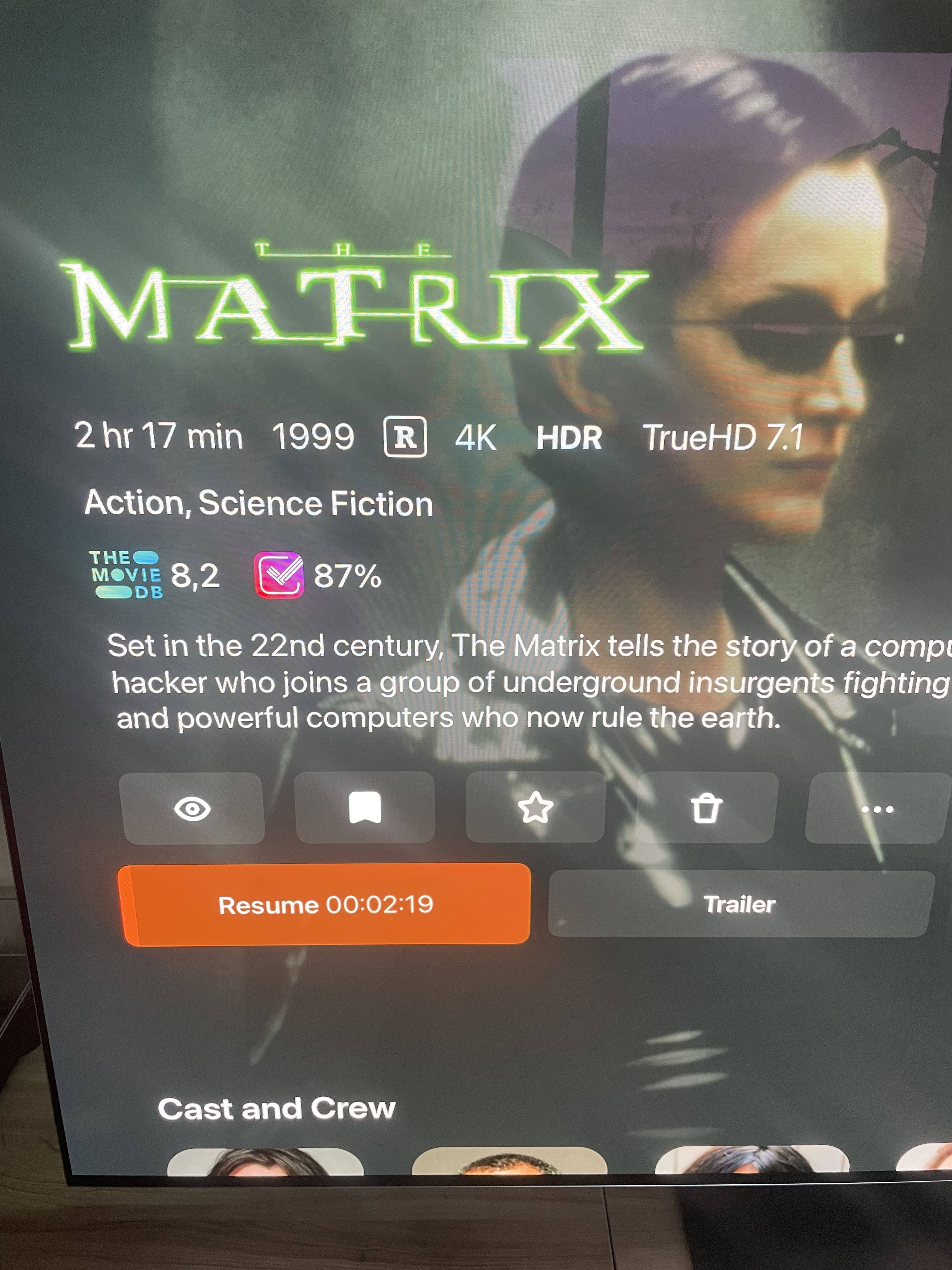

Infuse still shows HDR instead of DV on the Movie info screen:
The TV still goes into DV mode when starting the movie, so I’m not sure if it’s HDR10 or DV that’s playing. How could I know this for sure?
Just found the answer.
I cleared all metadata from Infuse and now they all show DV.
I think it got confused because the previous version all were profile 7 and it got stuck showing HDR.
Anyways, glad to know DV is working. Thanks for the help!
