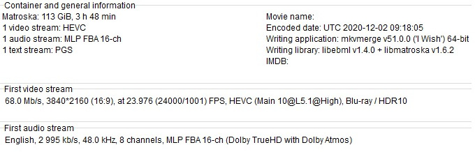

Hi! I believe my question is relevant to this post, if not please correct me. I am trying to play an mkv file with DV although I am getting only the HDR mark on my LG B7. There is a post saying “It is DV but since its the new single layer version mkv it only plays on Nvidia Shields & Plex. On everything else it will say HDR10 instead of DV.”
Since I am not using neither a Shield (ATV 4K here) nor Plex (playing my files directly from my PC via a NFS server) is there a way to see the file in DV? Thanks!
Can you post up the specs?
It sounds like it may be a single-layer with fallback.
You’d like the MediaInfo details? Or something more? MediaInfo states the file as HDR10 whereas it is stated in the filename that the file is a DV one.
MediaInfo should be enough.
Also make sure you have the latest version of mediainfo. They added support for DV in mkvs not too long ago
MediaInfo 20.09
Can you select the 3rd tab, and copy/paste the specs?
Screen Shot 2020-12-02 at 9.00.59 AM

This appears to be profile 7, which is similar to the examples from earlier in this thread.
This type of DV is not supported on the Apple TV, and these will play in HDR10.
Ah ic… OK then thanks for clarifying, hoping for future support then!
