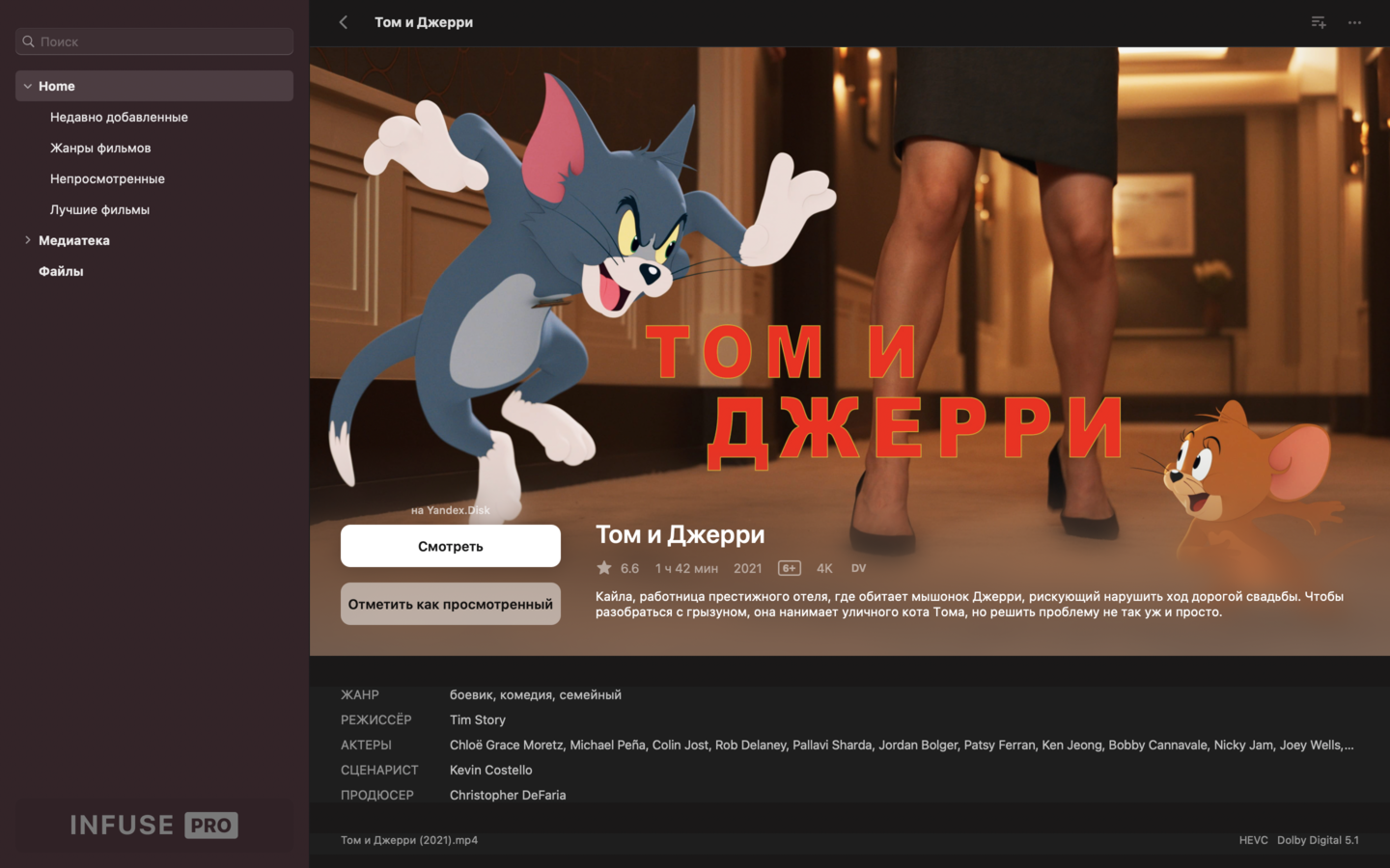

Hello. I have uploaded a cartoon in DV format. When playing on a MacBook pro m1 11.2 macOS, it produces incorrect colors. On the iPad Pro 2018 and other devices, there is no such problem with this cartoon (it does not have standing HDR, only DV) Will there be any fixes? Thanks.
Version: 7.0.3514 (r) beta2 (last)
XDMM0
What’s the Dolby vision profile? Post media info for the file.

Заголовок : Tom and Jerry (2021) - Release by Dolby Vision Torrents
Библиотека кодирования : x265 3.4hy:[Linux][GCC 7.5.0][64 bit] 10bit
