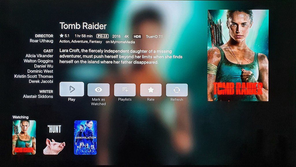

Finally I manage to get a Single Layer Dolby Vision file.
But I have issue playback as Dolby Vision by Infuse where it still detect as HDR instead of Dolby Vision.
But MrMC is manage and success playback as Dolby Vision.
I mentioned MrMC here is for proving the file is support Dolby Vision format.

MrMC manage playback as Dolby Vision
Infuse still detect as HDR and playback as HDR

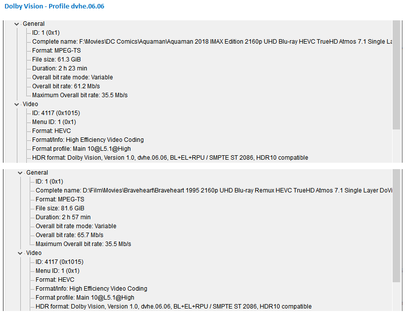

Update: Now I got another Dolby Vision title which is dvhe.06.06 which is not support by Infuse also.
MrMC as usual no issue playback dvhe.06.06 as Dolby Vision.

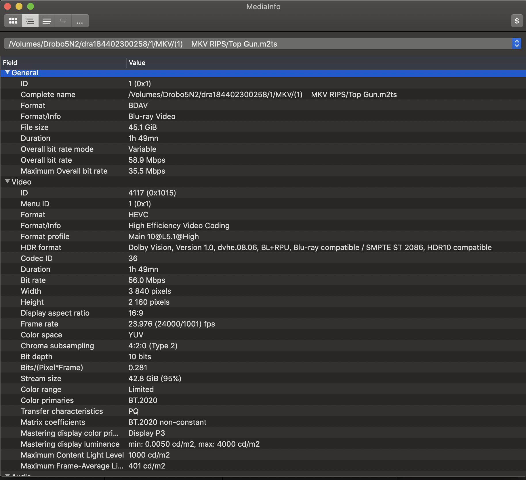

I downloaded MrMC today to see for myself. It is indeed playing a file showing as 08.06 DV in MediaInfo triggering DV on my LG C9. Infuse played it HDR.

I found dvhe.04.06 and 06.06 file on makemkv forum you can check uploaded to dropbox done.
I dont have TV w DV and I cant confirm this file but Andrewtst niteflyr can test it in MrMC.
