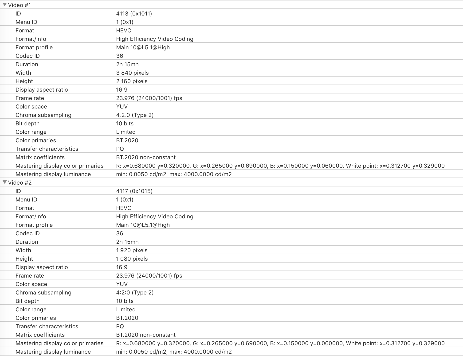

Actually, even though they have a Dolby Vision logo displayed in the video, I believe these are in fact SDR videos. My guess is these are marketing materials used to show the ‘potential’ differences someone might see with Dolby Vision. In this case, they would need to be SDR because the person viewing them presumably doesn’t yet have a DV capable TV. :wink:
Take a look at the attached MediaInfo specs to see the differences between an actual DV video and the Kodi sample. You will notice DV videos contain 2 separate video tracks.
Makes sense–thanks for the detailed follow-up!
