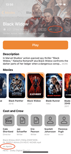

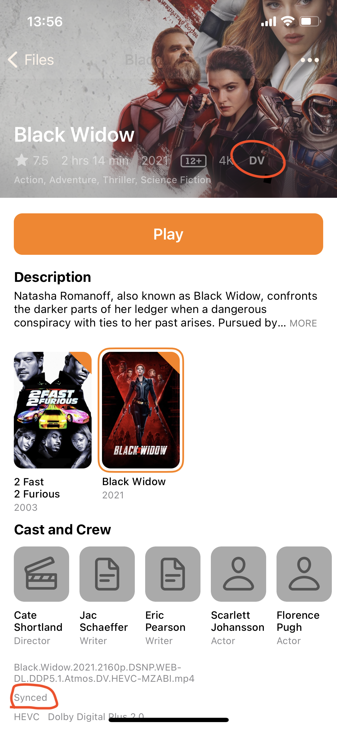

Hey,
I just noticed, that when viewing DV show or a movie remotely on plex, it doesn’t show the “DV” letters, marking it as DV file. However, when I download the file locally, it properly tags it.
EDIT: I just also noticed that it says, the file is DD+ 5.1 when viewing remotely, and DD+ 2.0 when synced locally.
EDIT 2: iPhone 12 Pro, iOS 14.6, Infuse 7.0.8

I moved your post to a related thread where this is explained.
