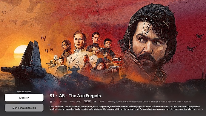

Have I gone mad now? I’m watching an episode of Andor on my Apple TV 4K 2022. Infuse indicates 4K HDR in the overview. I start playback and my TV switches to Dolby Vision! All this after the update to TVOS 16.2
This wasn’t the case before, was it?
