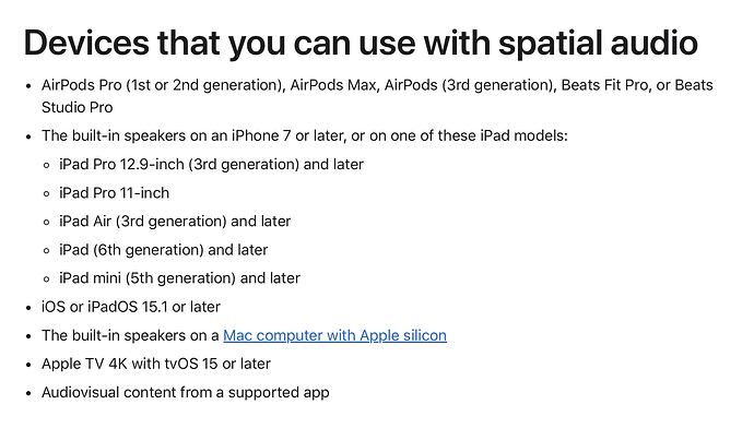

This is the compatible devices support page that Infuse’s page links out to.
It looks like Apple has recently rewritten that guide, but here is a screenshot from the original version which lists the compatible devices.

It seems the guide you initially linked to and the current one both are geared towards “Personalized Spatial Audio with Head Tracking”. Is the Personalized and Head Tracking bit essential for the reproduction of Dolby Atmos through Spatial Audio in Infuse? And what about wired audio? And is multi-channel audio sent as multi-channel over Bluetooth or is it downmixed to Stereo if Spatial Audio isn’t supported on the connected earphones?
This is more or less determined by Apple.
In a nutshell, if the system says there is a Spatial Audio (or multichannel) audio pipeline available then Infuse will use it. If not, then Infuse will provide stereo.
I can’t say whether there are any non-Apple headphones that Apple would recognize as supported.
