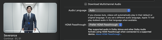

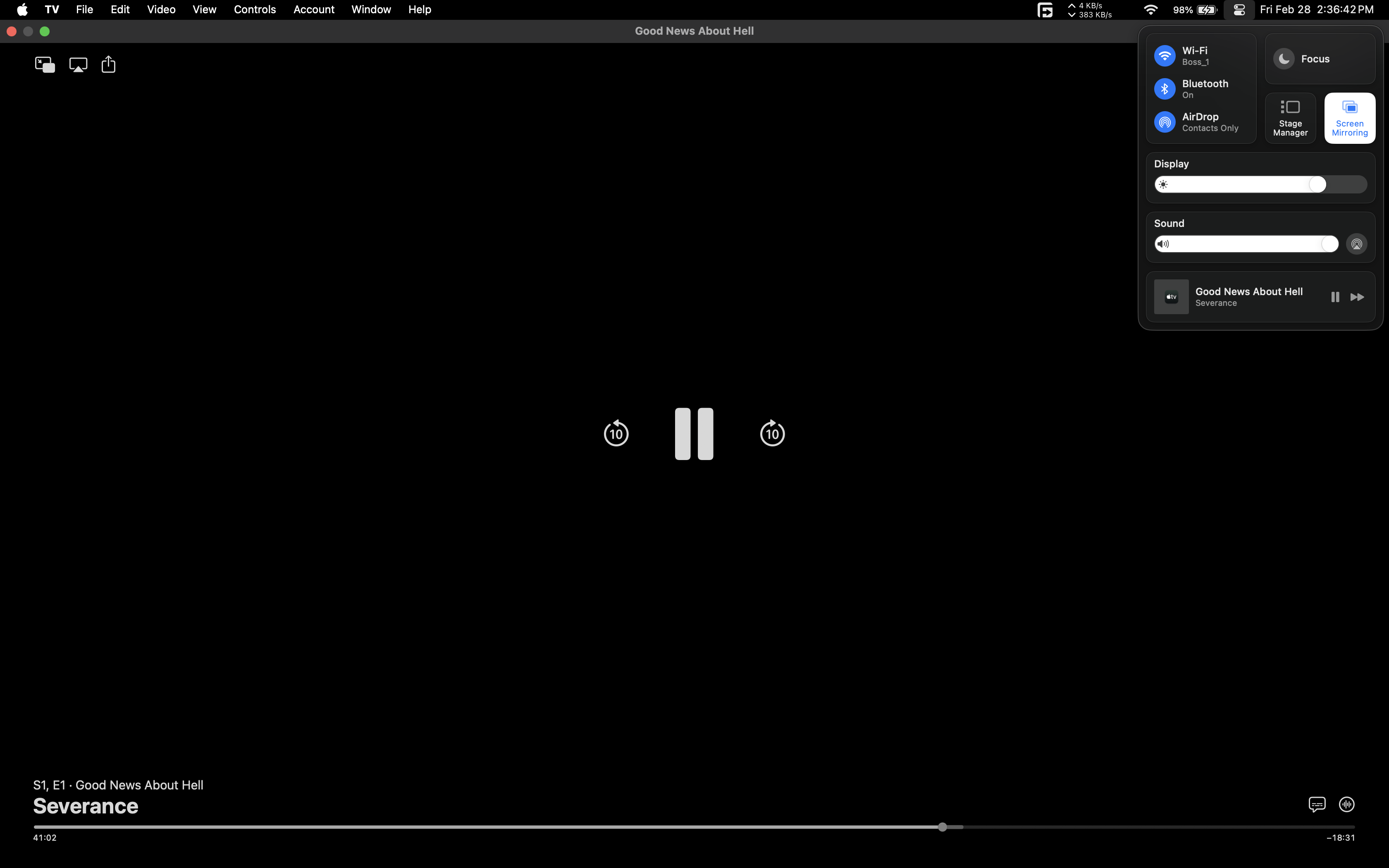

So I was messing around on my mac and i found out that you can play atmos audio if the audio is passed through directly to soundbar instead of being mirrored from screen. Let me clear it up when i used Apple TV app I got Dolby Atmos working fine and i saw that it doesn’t mirror audio when it does that instead it plays video on mac and passes the audio directly but on Infuse we have to mirror the audio to get the audio working on soundbar. if somehow you can find a solution for audio pass through like Apple TV app does it would help a lot. added some screenshot below showing audio pass through and screen mirror audio.
like adding an option for external audio device setting for pass through.

wait wait, you don’t need this either. i just did was directly connected to HDMI port of soundbar and in Apple TV it was able to output Dolby Atmos (soundbar shows that sign). no need of extra equipment. you can play Severance EP 1 its free on Apple TV for testing.
even it’s stated here how passthrough is working for these apps.
