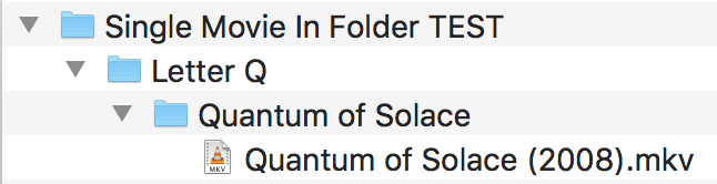

Yes, you can make it work by placing the single moving in a folder with the movies name as per the attached pic.
Ok thanks, I’ll sort that tomorrow.
