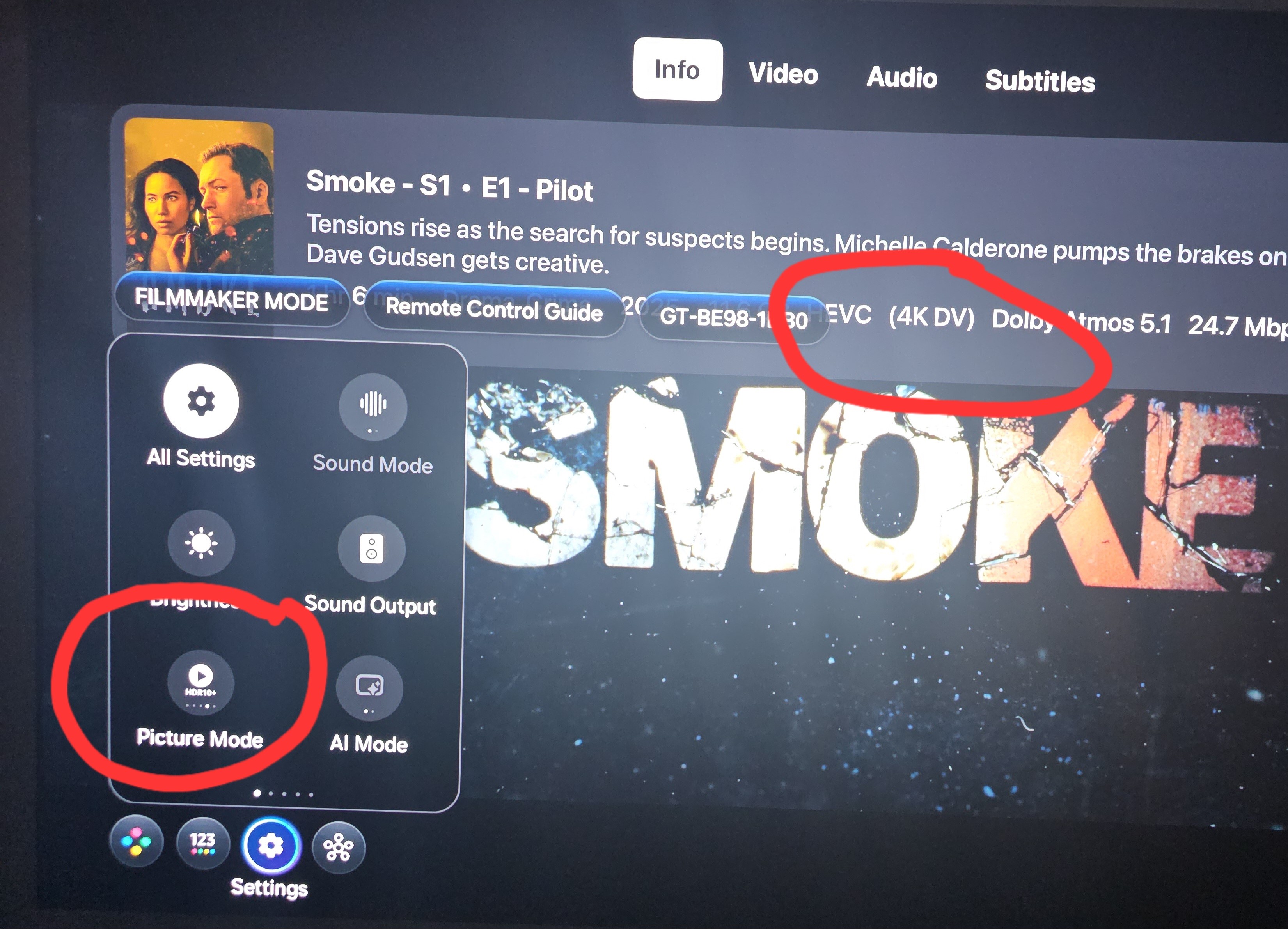

Display "HDR10+" along with DV on in metadata when HDR10+ is also available, not just DV
Hybrid video files containing Dolby Vison and HDR/HDR10+ tags, only display the DV tag as default as seen in the above image.
Can we get video files to display HDR/HDR10+ tags for people with non Dolby Vision displays, such as Samsung?

Also, I don’t think Samsung TVs support DV so it will fall back to the HDR format. In the pre-playback screen it will show DV as the primary encoding but will fall back for the devices that don’t support DV
Hi Thanks for your reply.
Samsung TVs do not support Dolby vision content, that’s correct.
The Issue is the files that are ‘hybrid’ containing BOTH Dolby Vison and HDR10+ formats, they default to labelling the file as Dolby Vison even when it’s disabled in the Infuse settings. 2025 has seen a surge of HDR10+ content and defaulting to Dolby vision, makes it’s difficult to know what content is HDR10+ in my library. Is there a way to add a setting to enable HDR10+, so it defaults to labelling the file as HDR/HDR10+ for non Dolby Vision TVs.

YES! Disable Dolby Vision in infuse settings and the method to see what type of HDR is playing is to use the ‘small remote’ and select settings and check ‘Picture mode’ make sure it is NOT on ‘film maker mode’ and you will see if it is HDR or HDR PLUS
Thanks, I’ve been able to confirm that Infuse recognizes and sends the correct format to the TV: HDR10 or HDR10+ in movies with multiformat video information. :smile:
The downside is that in the brief technical info Infuse displays, it only shows DV. :pensive_face:
