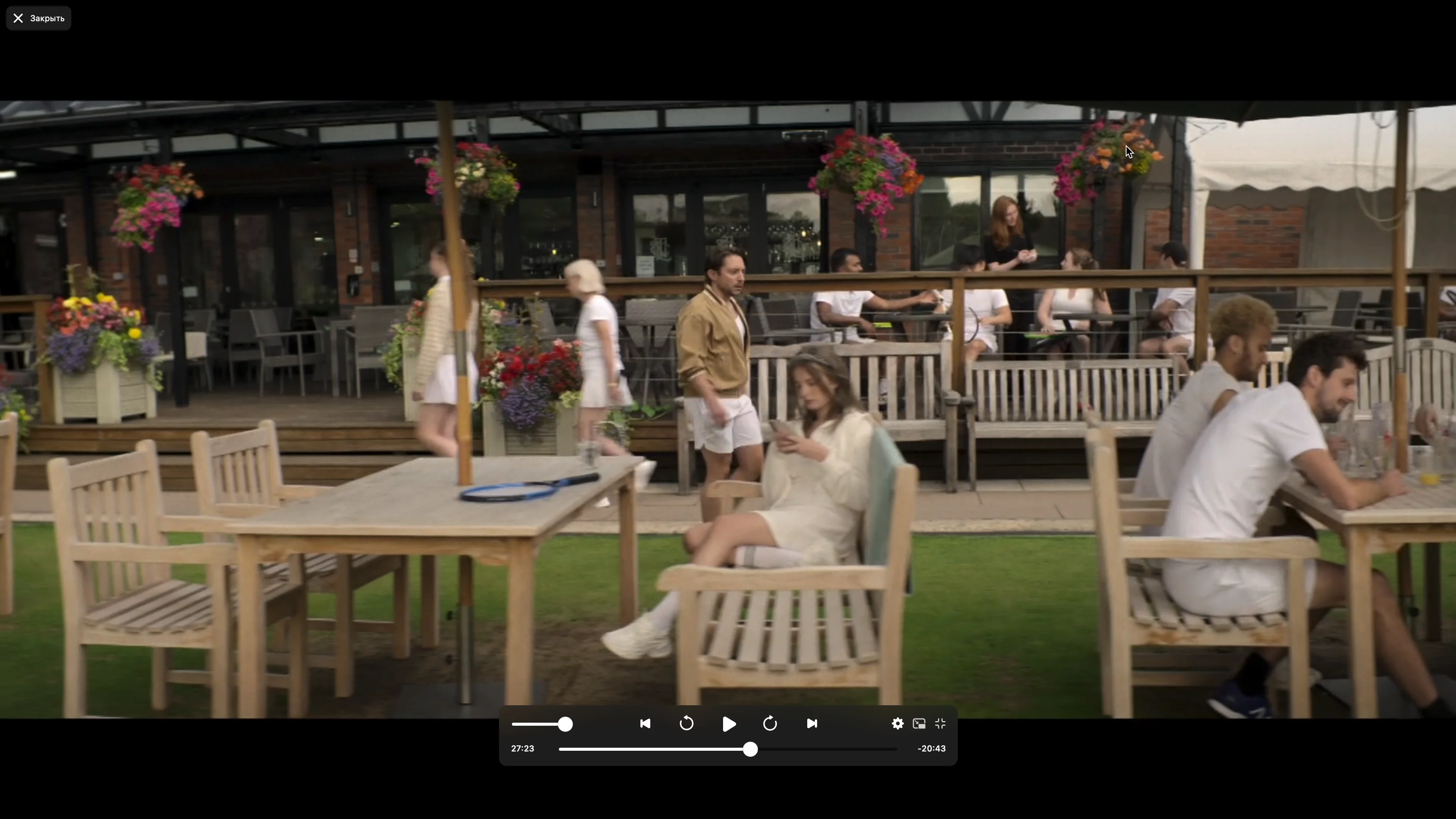

Hi!
When skipping forward or backward by increments of 5/10/15 seconds, playback for high-resolution or large-sized videos begins after a slight delay (0.5-1.0 seconds).
In contrast, other media players such as IINA and VLC start playback immediately for videos of any resolution or size.
For reference, I am using a MacBook M2 Max with 32GB of memory and a 30 GPU, running on macOS 14.3.1.

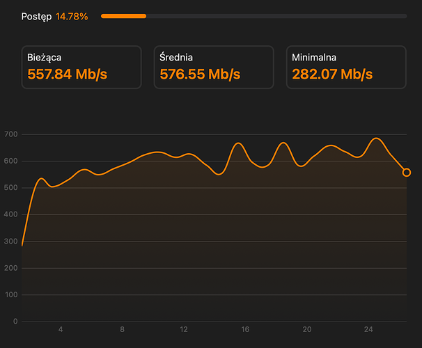

And try running a speed test in infuse
Indeed, this issue has been present since I began using Infuse on the Air M1. I’ve recorded a video to illustrate the problem more clearly. It doesn’t occur with all files, but with a majority of them, including some 1080p files.
Diagnostics: WYSM8
This too
Is this link related to a speed test Testing Streaming Speeds – Firecore Support? I don’t utilize such services as I typically run local files directly from my hard drive.
It still may show something and it’s pretty quick even for a big movie.
The graph pic usually shows if there are drops in the stream.

Running the test and posting the results and graph may have an answer or at least a direction to look.
