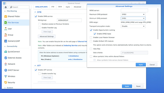

I already have “Transport encryption mode” set to disabled on my Synology NAS. I also tried using NFS and that behaved the same also. I also just now edited my share to use SMB2 and the delay was still there.

Many users have found they get best results using the “Legacy” setting on SMB… May be worth a try.
I just tried Legacy and it wasn’t any better. Attached are my settings.
