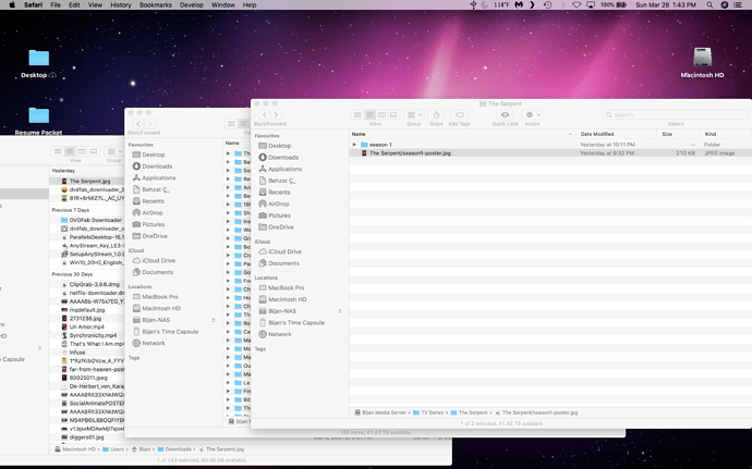

Thanks for your super quick reply NC_Bullseye. See screenshot I took. Open to other naming conventions if you have any thoughts.
Vivek

You still have the season poster in the wrong folder. It needs to be in the main folder named “The Serpant” not inside of the season 1 folder. Second, fan art should be labeled “fanart.jpg” not “The Serpant-fanart.jpg”. It too should be placed in the folder “The Serpent” like the season posters. The second fanart jpg you have is not even inside the series folder so it won’t be seen. See if that helps some.
Also if you’re going to use the name season 01-poster.jpg" you should have the folder for season 1 named “Season 01”.
For the names you currently have on the season folders the poster should be named “season 1-poster.jpg”.

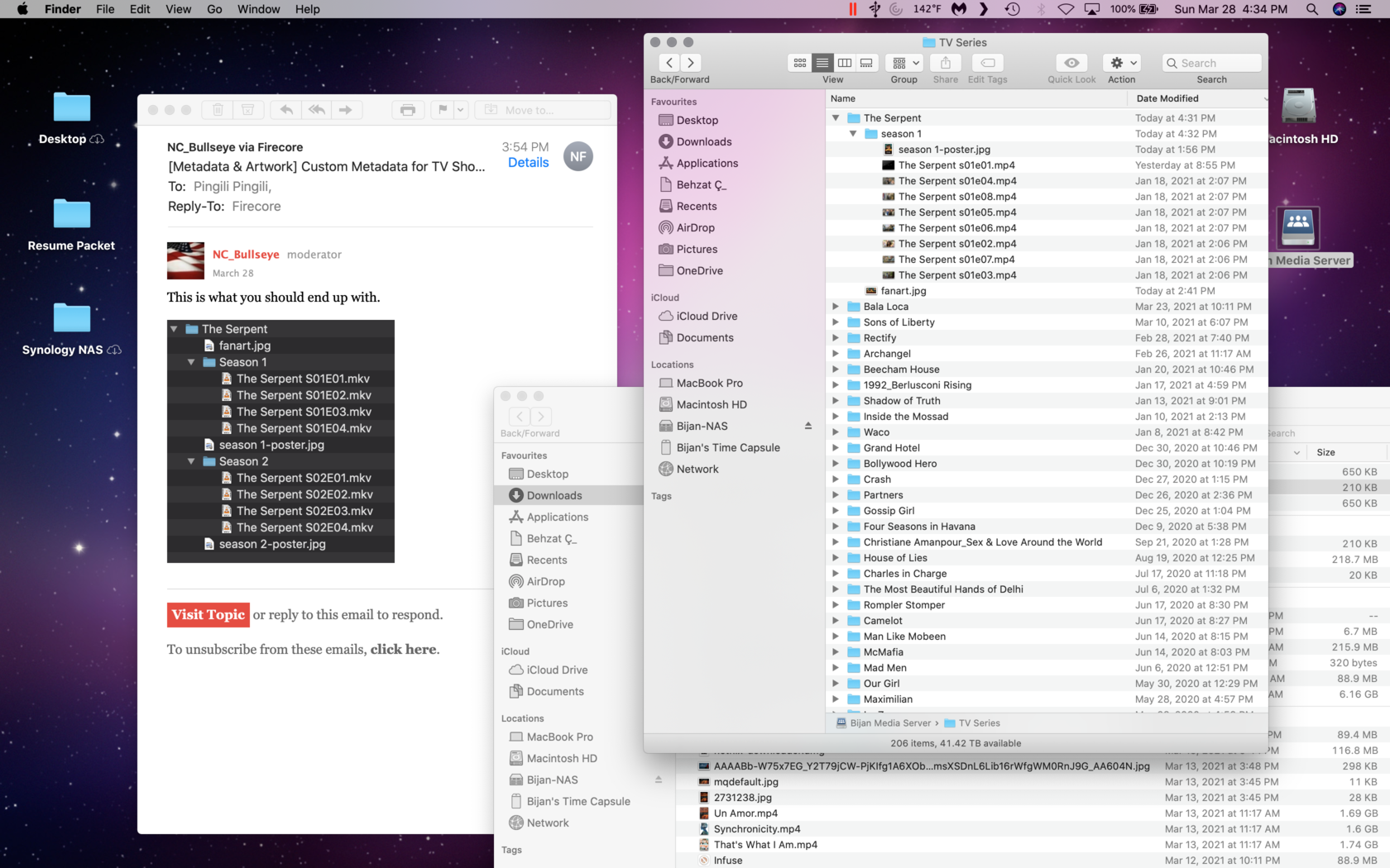

This is what you should end up with.

IT WORKED!!!
Here is the config I did it. I am going to replicate this for multi-season shows I have as well. I am thinking “folder.jpg” is the portrait poster for the entire series, “fanart.jpg” is the landscape view for the entire series and I can have different posters for different seasons using “season 2-poster.jpg” and so forth.
