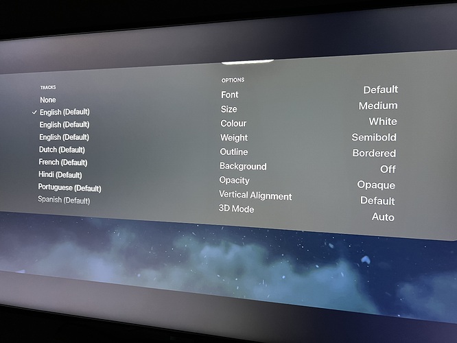

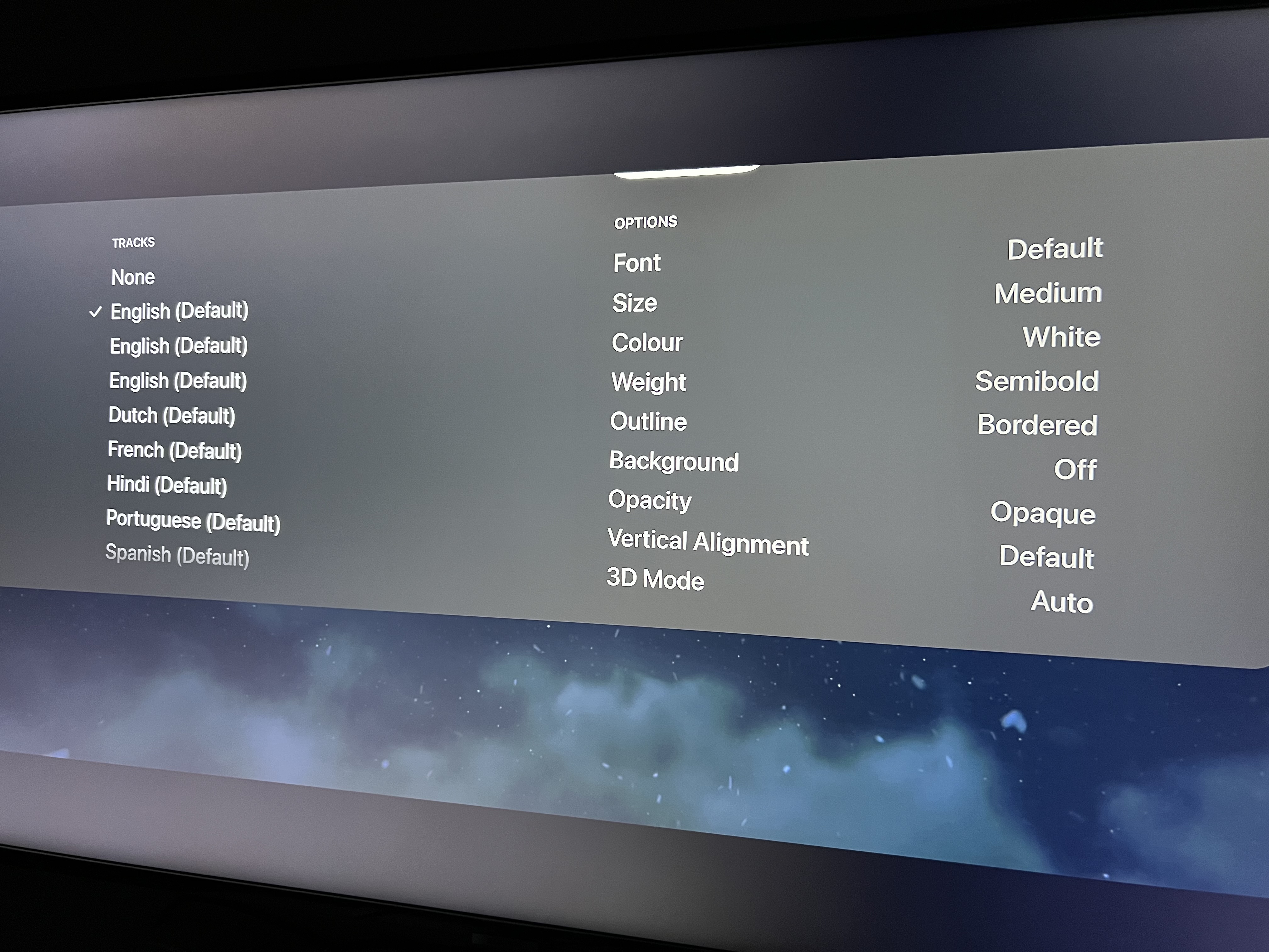

I’ve noticed that the black bars on some content overlays menus & system dialogs such as the Infuse top sliding menu or AirPods system notification/dialog.
Occurs on Apple TV with Infuse version 7.5.2 (4410).
At this moment I can not upload images (“Sorry, an error has occurred.”) to this post but I’ll try again later and attach some examples. Images embedded via Imgur.
Image 1: AirPods system dialog
Image 2: Playback menu

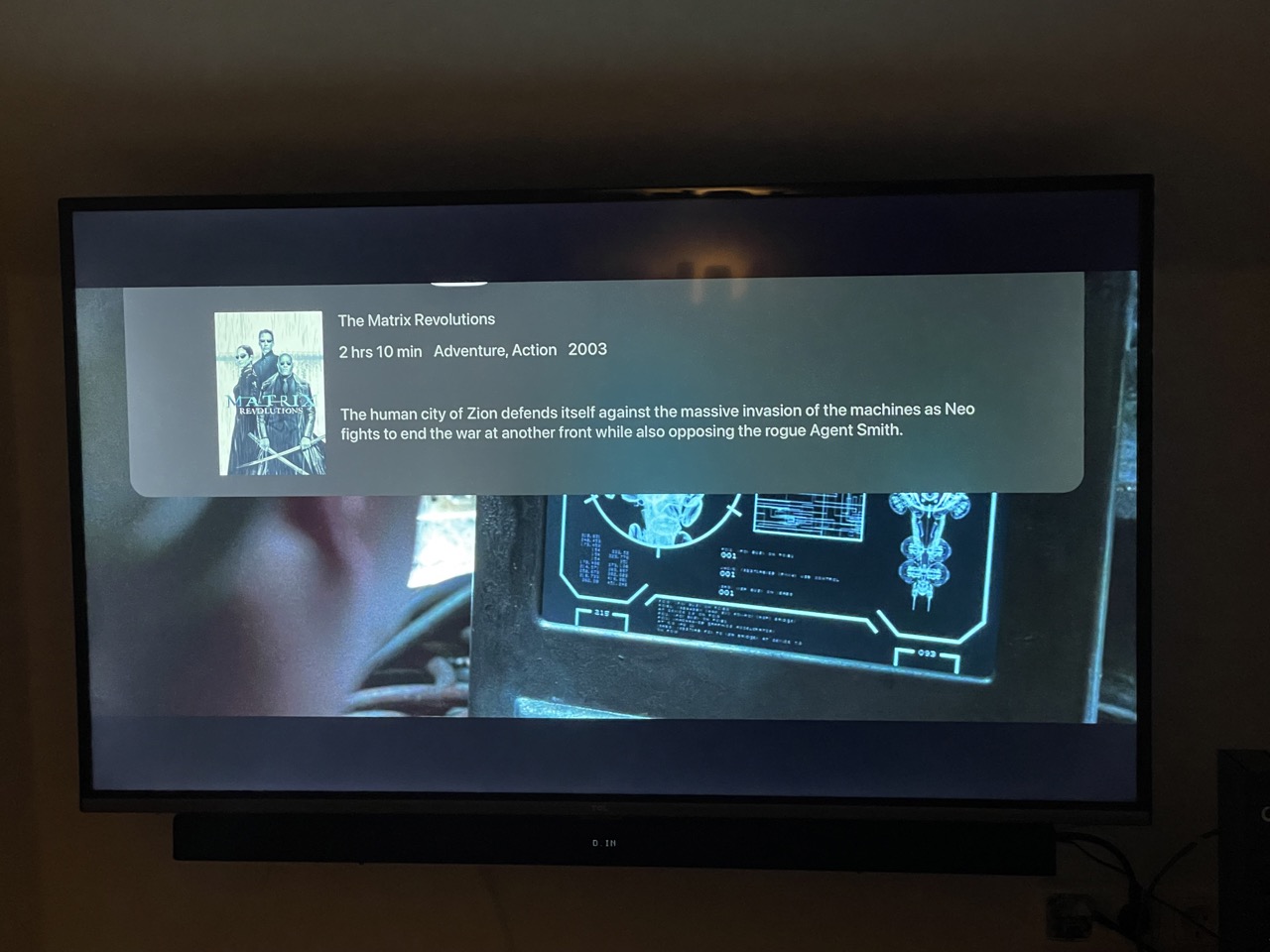

Hi there,
Since about 1 month, I’m experiencing an anoying bug that never happened before.
On some movies, not all, the infuse HUD is hidden by the black borders of the movie ( where we can select subtitle / audio tracks, or the timeline at the bottom ).
You can check that here, and enjoy my son’s lullaby :rofl:
I don’t know if this is a TvOS issue or Infuse, but it’s really annoying, especially when I want subtitles, which are hidden too, so I have to manage a custom vertical alignment as workaround.
Is that a known issue?
Thank you
Does disabling the ‘Extended Dolby Vision’ setting in Infuse > Settings > Playback make a difference?
I went ahead and moved your post to a currently thread discussing this issue.

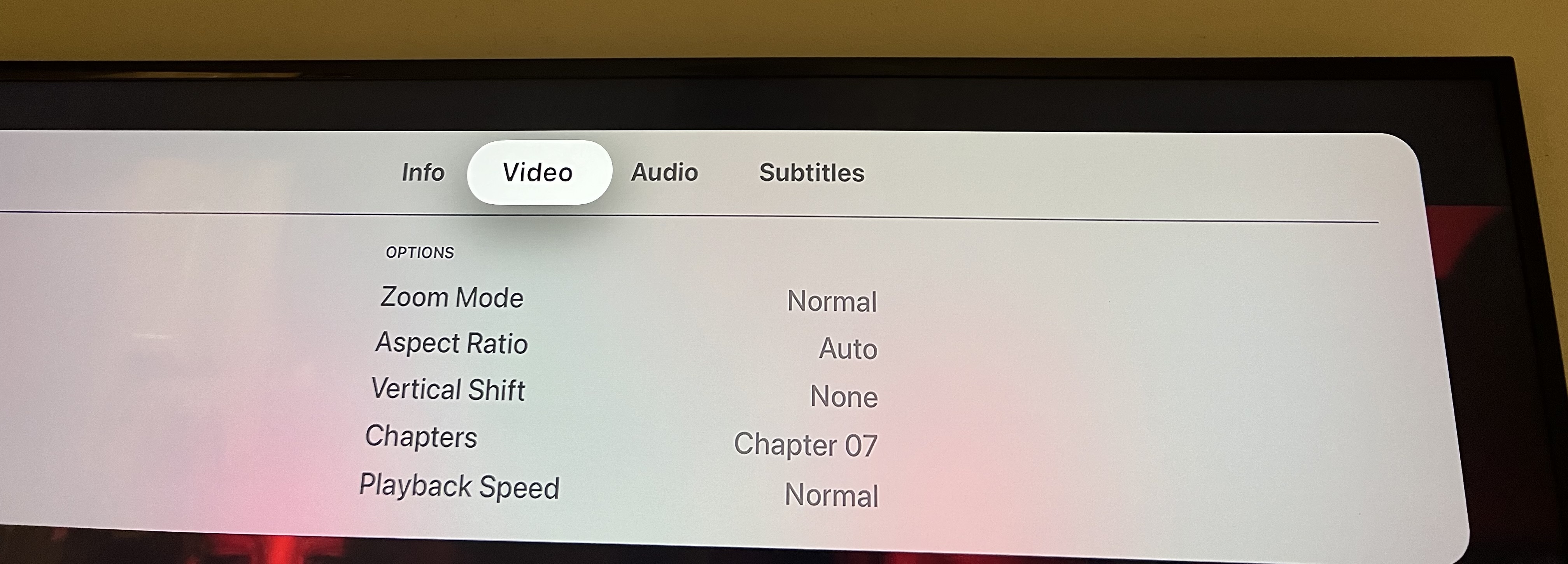

Sorry for necroing this topic, but the issues still persists on my television.
I have an LG C7 television and this only happens with DV mkv files. I play them on my AppleTV.
I have the same issue as the other people in this topic.
Things I have tried (after reading this topic):
  • Reset Apple TV’s video settings and re-enabled Match Content
  • Disabled the ‘Extended Dolby Vision’ in the Infuse App.
This doesn’t seem to help. Rather annoying, now I can’t read my subtitles. Any suggestions?
Can you run one of the videos that you’re having issues with through mediainfo and post the results here?
