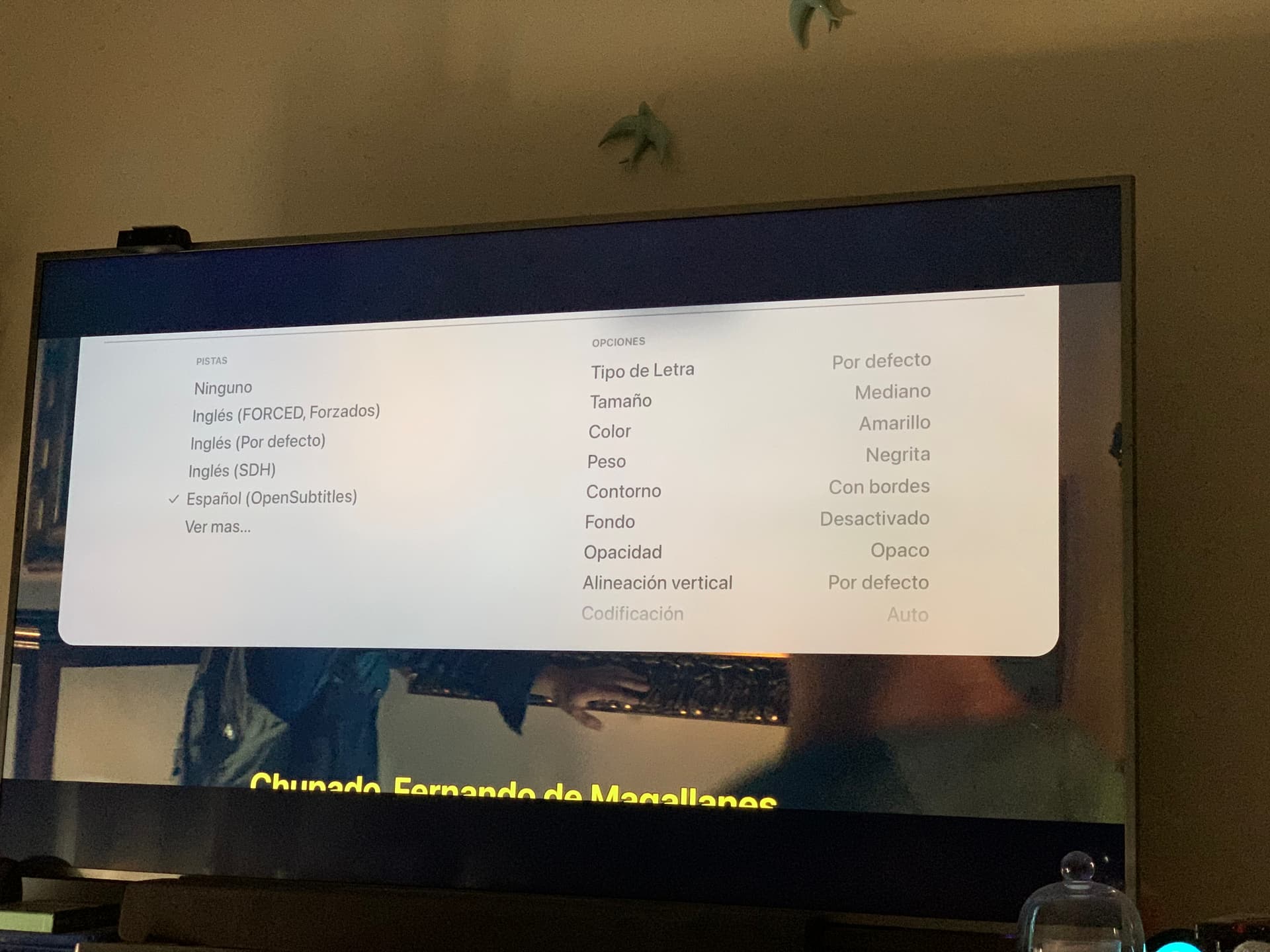

I have tried a file in MKV (DV) and it plays correctly but when I put subtitles they appears under the black lines (also the interface).
I have try with the same movie in MP4 (also DV) and the problem persists.
That really looks like a setting on the TV to me. I tried to replicate it and the subs always overlapped the burned in black bars. Does your tv have a crop setting?

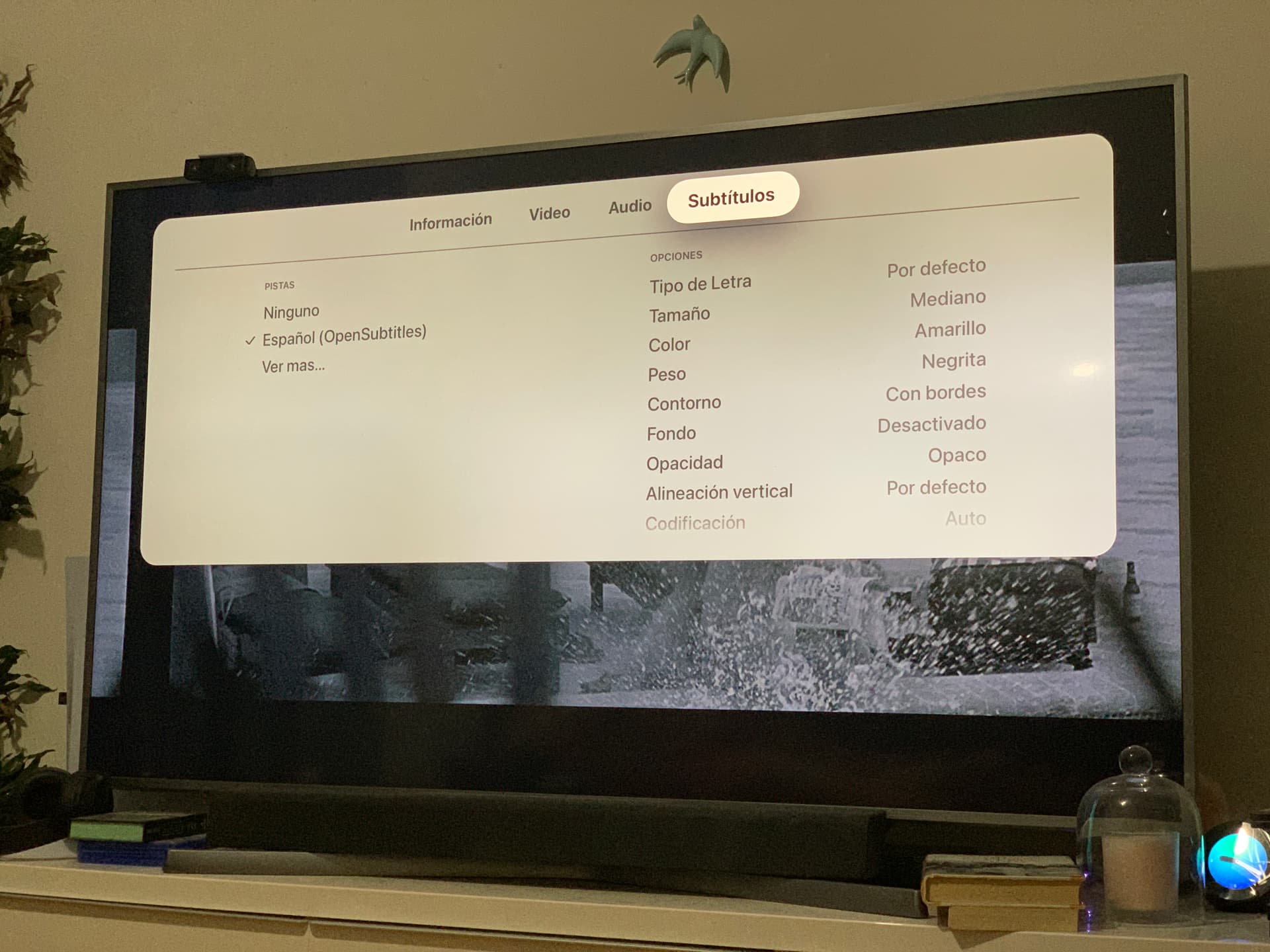

Where you show the top of the menu box where it has “Tracks” and “Options” there should be another row above that that the ATV puts out that has “Info Video Audio Subtitles”
Like this.
Note that your menu only has rounded corners on the bottom meaning the top has been cut off.
This appears to be a zoom or crop issue.
To add here’s where the subs overlap the bottom black bar.
I don’t think so. Look at this one (1080p x265):
