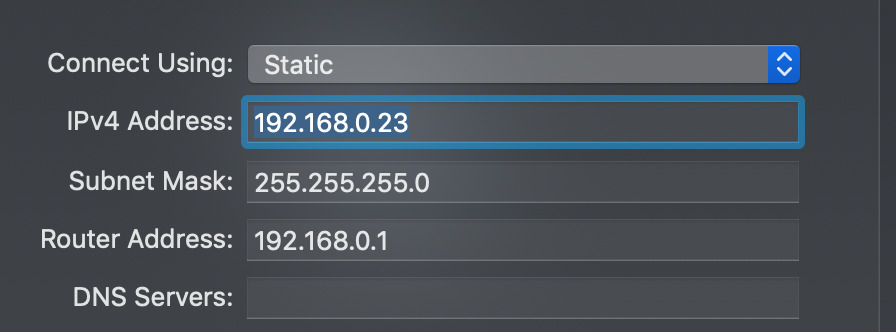

  • Address: 192.168.0.023

This product only supports AFP and SMBv1, try switching modes to solve the problem, and use router address to connect.
