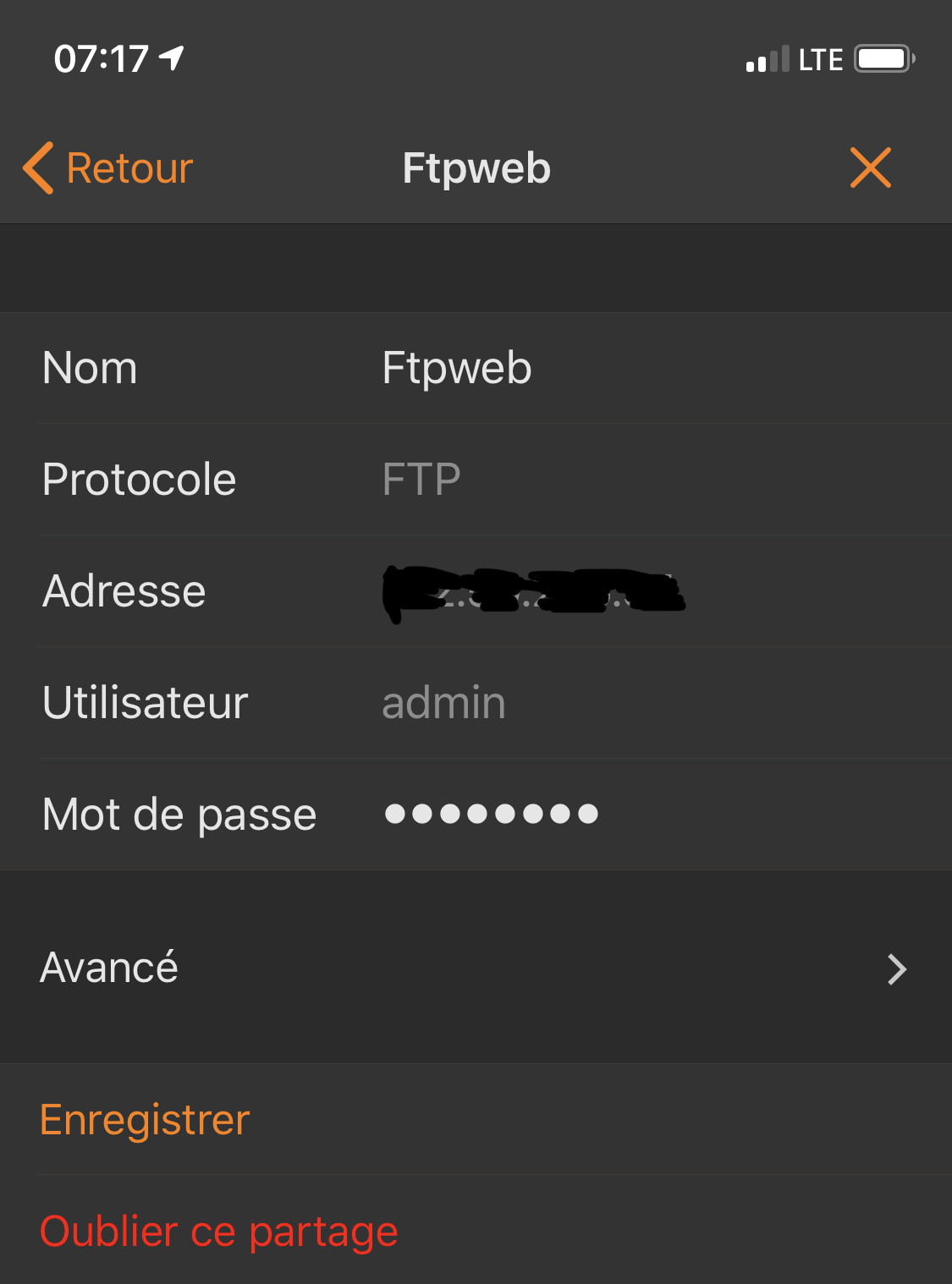

I have the same problem with my TS119p+. So I have 2 QNAP NAS in my network.
I open port 21 on my routeur
Entered my external IP address like xx.xx.xx.xx
User & pass
And it’s not worked …
Can you connect to it with an FTP program on a desktop? If not then you have something wrong with your settings in either your NAS or your router.
