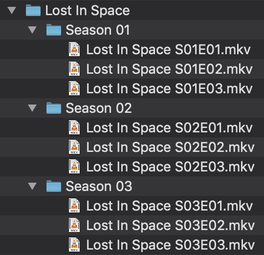

How do you have your files named for the TV series?
Each folder just has the series name. For instance, Doctor Who (2005) is Doctor Who, Fringe is Fringe, Farscape = Farscape, etc. In each folder, the naming convention is 1x01- blah blah blah, or just 1x01, to indicate respectively if it’s an untouched or modified source.
The following example will get you about 99.9% acuracy for fetched metadata and artwork. You will rarely need the year for TV series unless there are multiple series with the same exact name.
The Season folders and the full series name for each file will really help.
Roger, looks like I’m about to get cracking on some file renames (or about 1,747. oof)! Am I able to continue with my convention of attaching the name to the end of them? Will that adversely affect the scraper?
