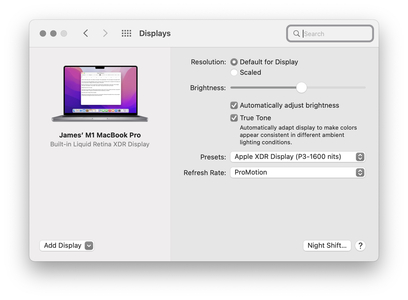

Also, have you changed any of the display settings?
I’m testing with the default settings.

I’m on the new 14 M1 Pro. The problem happens when I play on fullscreen and enable ProMotion only. If I fixed refresh rate to 60Hhz the problem is gone. So, it seem related to the new refresh rate thing on the new display. Hope this helps!
