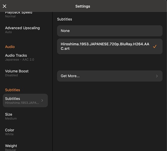

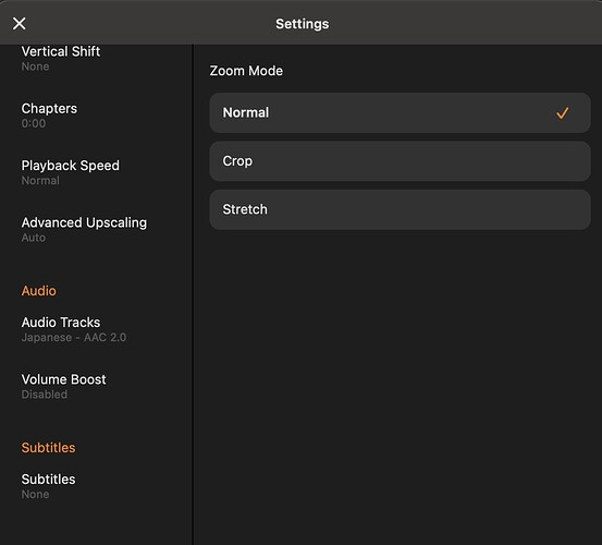

Go to gear
Gear
Click on Advanced and scroll down to the subtitle section
Click where it says subtitles/none and select the one you want.
Then you should see the options available to change the font type there. Size, color, weight, background, etc.
Of course I have the subtitles. Can you show me exactly where I can change the font type? I see other options like size, colour, weight etc. but not type.
