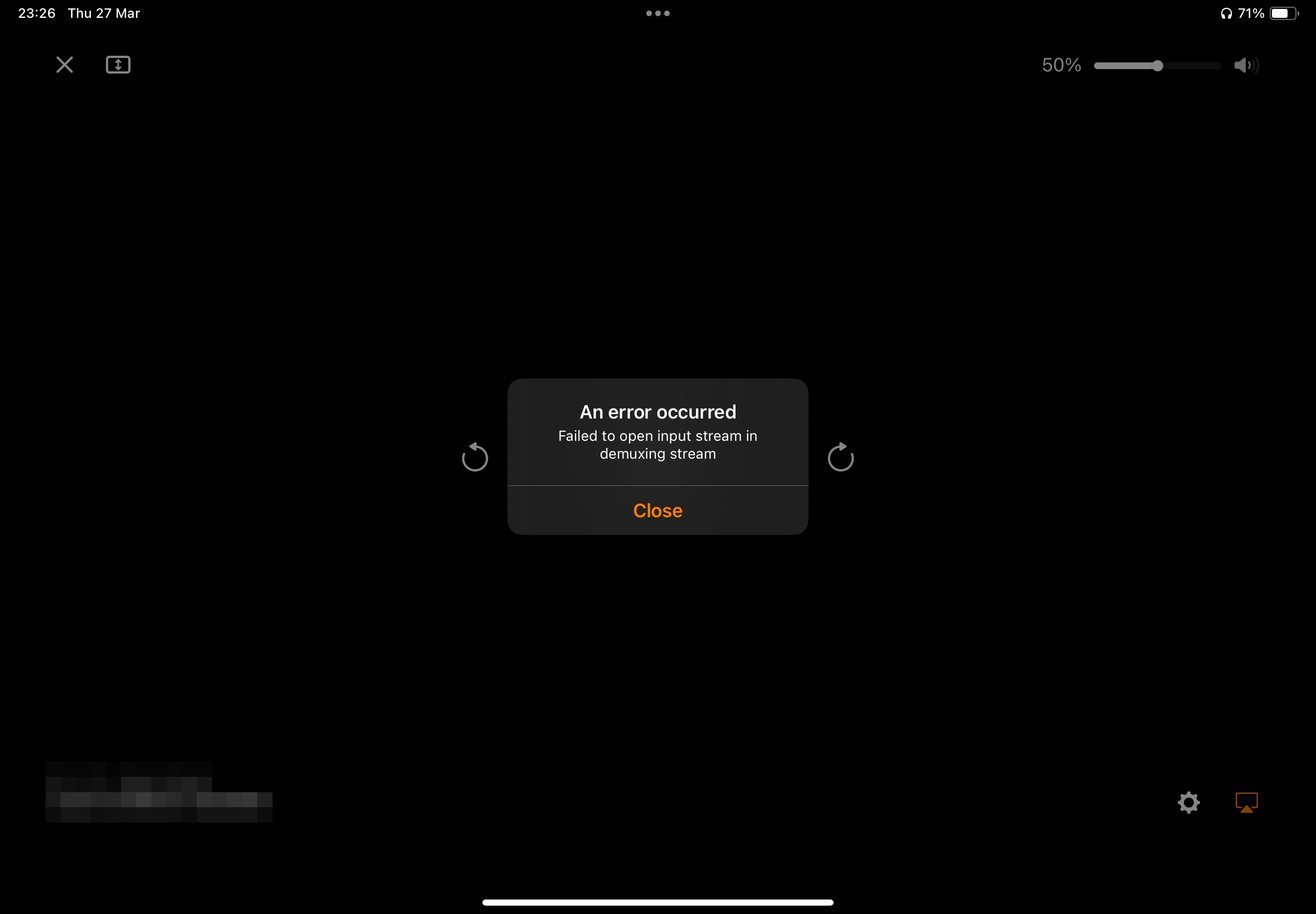

I can stream and download from my Plex server normally through Infuse on iPad (A16).
However files I download from different movies or TV series can’t be played and display error “Failed to open input stream in demuxing stream”. Disabling iCloud sync didn’t help.

I’ve updated to 18.4 and Infuse 8.1.3 but the issue persist. I found a workaround but let me know if it’s an intended behavior. I sent another diagnostics report under APXQQ.
My setup:
  • iPad (A16), iOS 18.4 (on same network and VLAN as Plex server)
  • Infuse 8.1.3, Plex is the only share on it
  • Plex on local network
Steps:
  1. Open Infuse
  2. Download episode of TV series from Plex
  3. Disable Network
  4. Hit play
  5. Go to Files in main menu and find your downloaded file
  6. Hit Play
Expected behavior:
After downloading an episode from Plex, disabling network and tapping play the downloaded file should start playing immediately. There are also no duplicates in Continue watching section.
Actual behavior:
After downloading an episode from Plex, disabling network and tapping play the downloaded file you get an error “Failed to open input stream in demuxing stream” which applies app is not switching to a locally downloaded file after it lost connection to my Plex server. Going to Files and tapping Play on the downloaded file plays that file immediately. Returning to Home screen you can see the same episode twice in Continue watching section.
