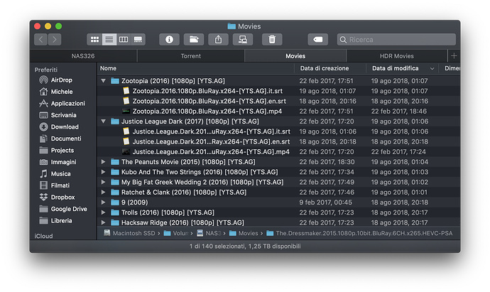

You can see it in the attached screenshots. The first column in Finder is “Creation date” and the second is “Modification date” (translated roughly from Italian). You’ll see that I ordered the files in Finder by the modification time, and that’s the same order in Infuse (one on the left is from a different folder), but the creation time of both folder and movie file is older.
I have also checked in the SMB server (Linux+ext4). the timestamps match the ones in Finder in macOS.
