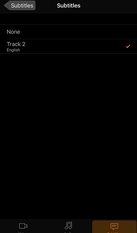

Any MKV container that contains subtitles, at least in my case, seem to gain a ‘mystery’ subtitle track selection after downloading to the device.
I have uploaded two images, when playing the exact same file, showing what the subtitles viewer shows when streaming from my NAS and when playing the saved file directly from the device. You can see that some additional subtitle track ‘English’ has appeared when playing the file saved to the device.
This wouldn’t necessarily be a problem, but it seems as if this ‘mystery’ track is very prone to going out of sync. It is also ALWAYS selected by default over the ‘proper’ embedded track. I have noticed that it doesn’t always go out of sync, normally if I start the file from the beginning then I won’t notice the difference, but I’m fairly certain that any file resumed will go out of sync with this ‘mystery’ subtitle track selected. Any file where I have selected the proper embedded track, and then resumed later works as expected/perfectly due to it remembering the subtitle selection.
This isn’t just limited to a particular file, it appears to be anything that contains a single embedded subtitle file. For a file that contains multiple subtitle tracks, no additional tracks seem to be added - e.g. if you have ‘Track 0’ and ‘forced’, no mystery ‘english’ track will appear. But if you only have ‘track 0’, then a mystery ‘english’ track does appear.
I have checked the file that is saved to the device, and no additional tracks seem to be located in the same directory or added to the container - so where is this track coming from and why? If it isn’t added during streaming, why is it appearing on local playback?
Happy to do some more testing / provide more examples if required. I haven’t tried to download files via a different method yet for example. Currently tested on an iPhone running iOS 10 and an iPad on iOS 9. Have plenty of other devices to test on (including iOS 11 soon) if required too.

Infuse has a feature which will auto-download subtitles for synced/downloaded files. You can disable this by turning off the ‘Show Subtitles’ option in the sidebar Settings menu.
Thanks but would that not disable all subtitles from automatically being turned on though? If the flag was set to ‘default:No’?
What about forced subtitles, do they follow the ‘show subtitles’ rule? Guess I’ll do some more testing. I don’t really like the idea of having ‘show subtitles’ option as actually ‘download subtitles automatically’, it’s a bit misleading, especially when it does two different things based on synced vs streamed.
Infuse will honor the forced and default flags for subtitle tracks if you have either of those set.
Forced subtitles will appear even if the Show Subtitles option is disabled.
Thank you James, you have been very helpful and I have managed to find a workaround for this ‘feature’.
Not sure I completely agree with tagging the automatic download setting onto the global ‘show subtitles’ setting but I guess there is more important features to work on.
It would be good if you could look into adding a standalone setting to automatically save subtitles at some point in the future.
James, I have just noticed that there is a (new to me) option ‘Download Subtitles’ that appears to be exactly what I wanted - which was to disable Infuse automatically downloading subtitles for a local file.
Any rough idea of when this option went in? I had been avoiding subtitles due to this and somehow missed this option being added till I decided to properly browse Infuse 6 (though I can see the option is also in Infuse 5).
Regardless, I do just want to say thank you for adding the option!
