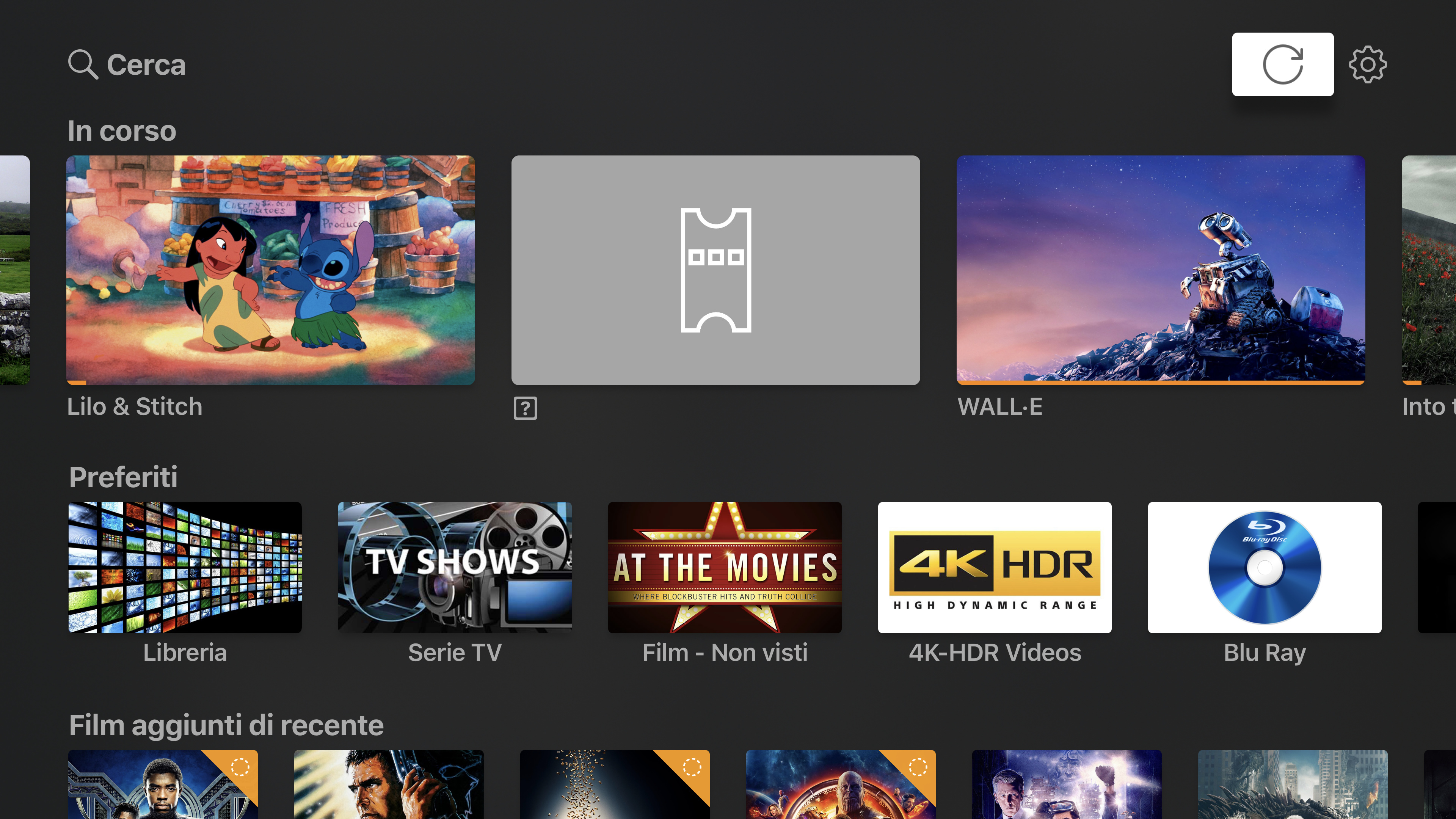

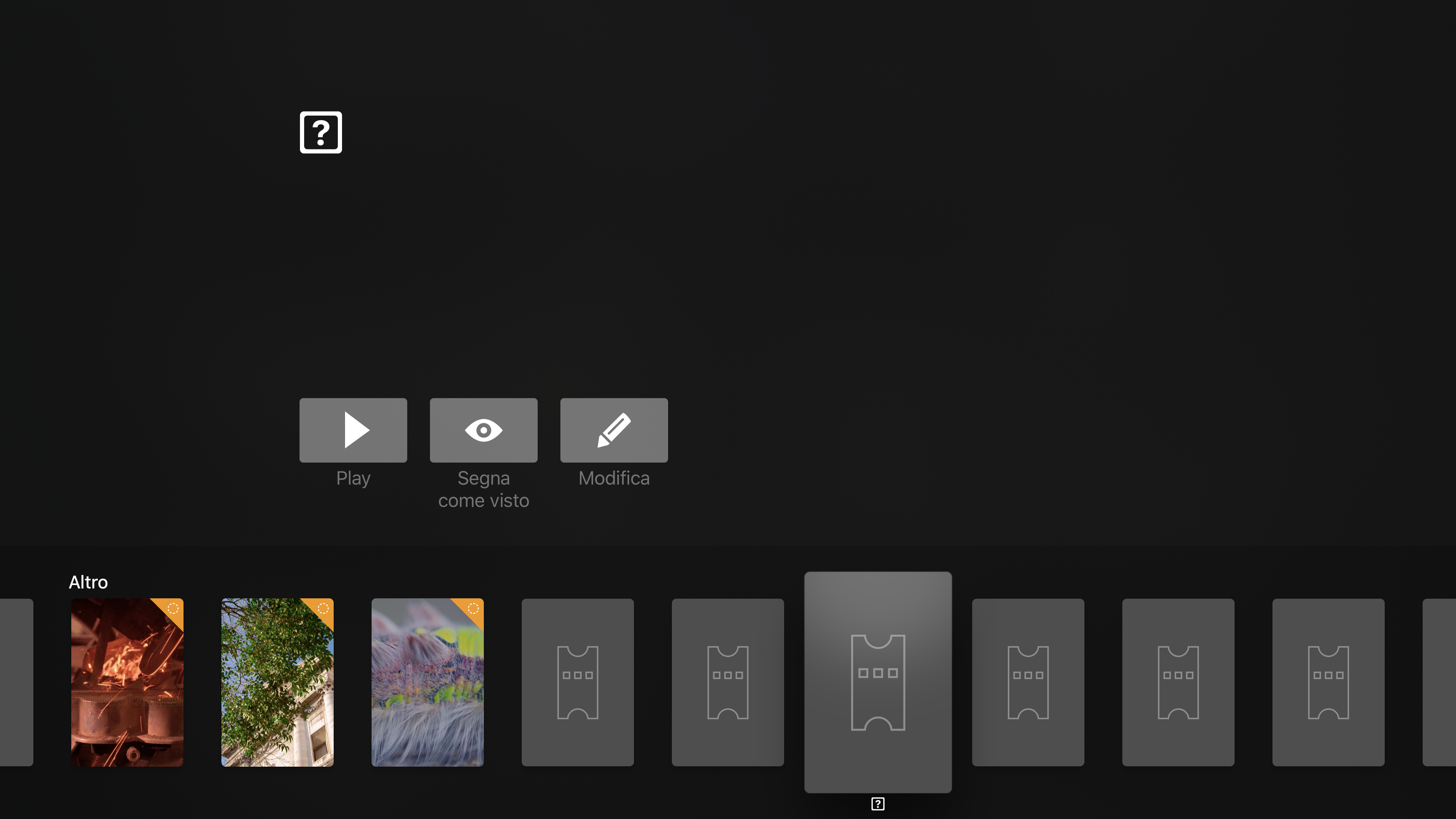

I believe it started with 5.8.1, but I noticed it first on my iPad (and I don’t know if it propagated from there). I have [?].mp4 (or at least the few I checked have the .mp4 extension) appearing all over, but their presence is massive in the “Other” section of the library. What I don’t like is that they also are in the middle of the “Currently watching” list (both Top Shelf and in-app) and I have no clue if they were pointing to a real video or else. I’ll attach few screenshots to explain better. In one all the grey icon show as [?] files. The third screenshot (at_19.04) shows what I get trying to modify the metadata (I actually used that to see what was the filename).
I have tried to delete and rebuild the whole meta-data, but nothing changed. I have also tried to remove all ._.mp4 files in my video libraries, refreshed the metadata but nothing changed again.

What happens when you try to play it?
If I play any of them they give an error. I’ll attach another screenshot. Also I have “illegal” (Japanese) characters on songs. They may show weirdly, but they play via iTunes/Computer. I just added a couple of movies in the last couple of weeks. Plus a couple of 4K HDR/HLG demo videos in a folder that uses local metadata. The two videos just show (and play) from the “Other” section, as well as from their folder. The movies are fine.
