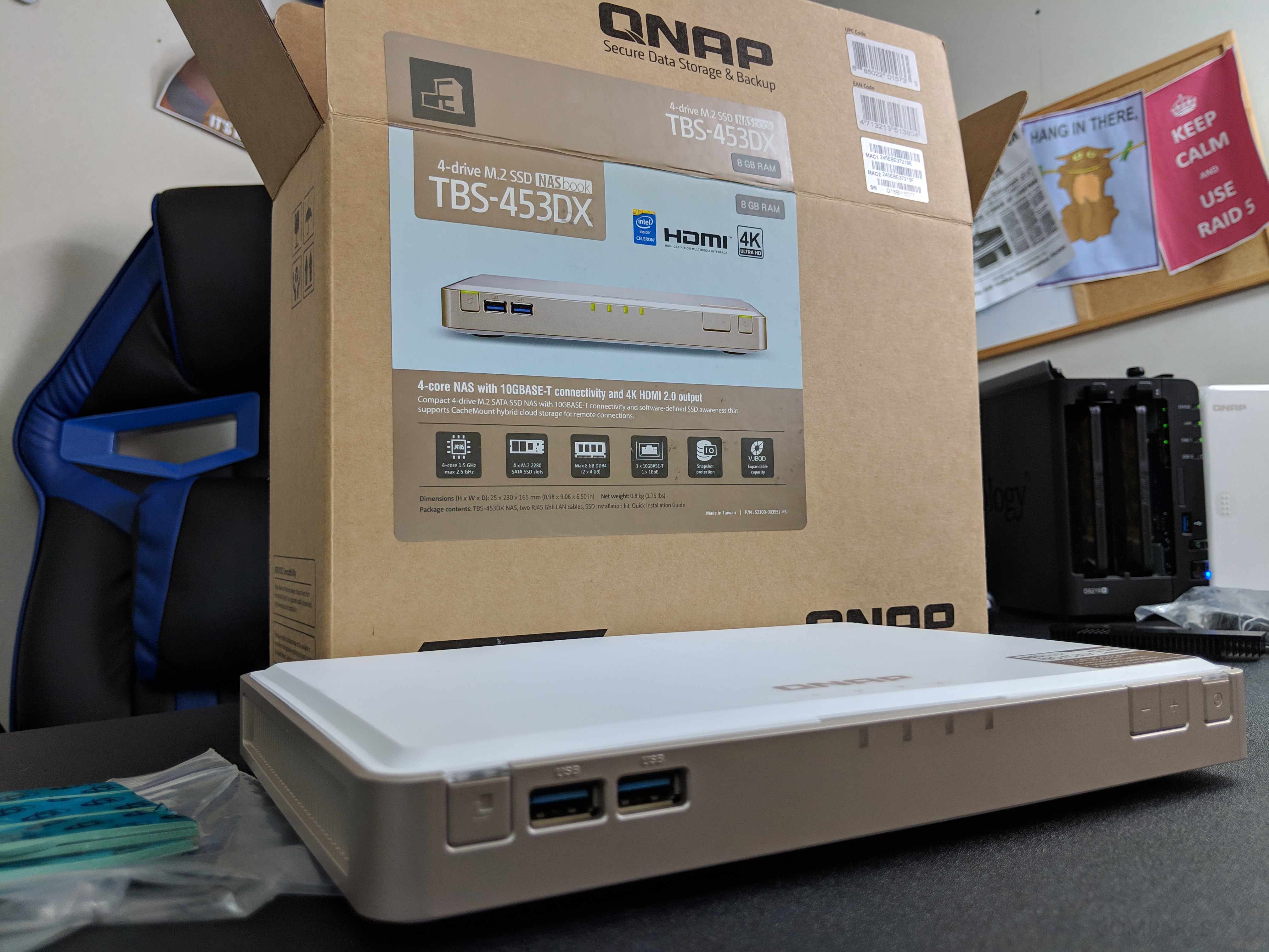

I’m thinking about getting this and almost using like a DAD right next to the ATV?
