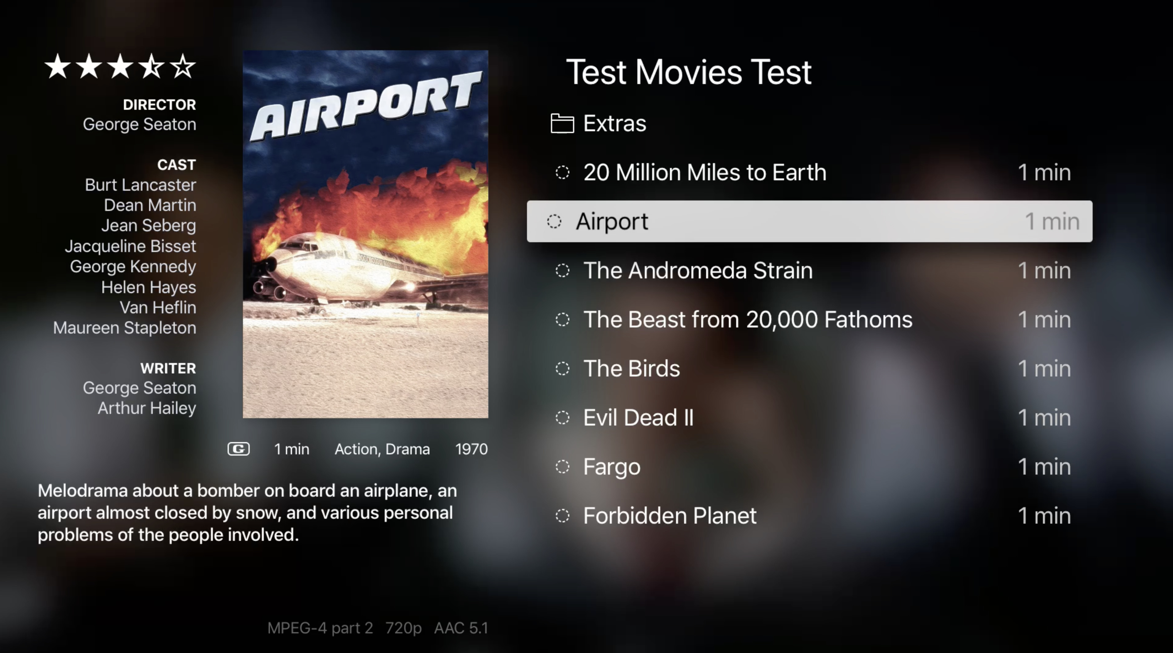

Sure, while you’re browsing your files most of the info is on the bottom of the screen when you’ve highlighted a file. Look on the bottom of the pic I’m posting and see where it says MPEG-4 and it will tell you the resolution such as 720p and the audio encoding such as AAC 5.1
If you see HEVC or x265 at the beginning then it’s using a higher compression codec and occasionally may be an issue for the ATV 4 to play for some of them but usually not. If it says “4K” resolution then it will definitely be tough for the non 4K ATV to play.

You can post the info provided on your screen at the bottom to see if there’s something that may be causing your problem.
Thanks. It looks like that information only shows in list view. My video says H.264/MPEG-4 part 10 1080p DTS 5.1. Which I have Find Nemo with the same file information and I didn’t notice any issues with that movie.
