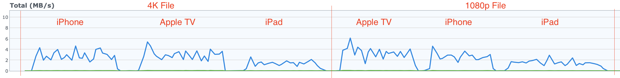

I’ve done some tests on my side as well, I don’t get as much transfer speed through wifi on my side but can definitely see a difference between my iPad and iPhone/Apple TV. I didn’t go in as much details and don’t have the information about previous versions of Infuse.
Your 4K file obviously kept buffering almost every second for me on any platform, my 1080p file did buffer only on my iPad as it didn’t need as much bandwith but I only seem to get half the bandwith on ipadOS vs iOS/tvOS
Also I can tell I could get more as when downloading the file I’m above 10mb/s

I also have an Apple TV 4K, and I’ve just done the same test again with WIFI on that (normally I use a wired connection.)
So same test with Apple TV 4K WIFI … Play 3 mins, Pause 2 mins, Play, Pause, Stop
TV OS 14.0.2
My 4K videos play back fine on Apple TV and the graph shows the same kind of results that I got on the iPad prior to the 6.5.3 Infuse update.
I’m still concerned that the data transfer drops in pause mode though, and that the maximum transfer speed is only 15 MBytes/sec. These in conjunction mean even in this “working” case, the streaming cache is not working, because it never transfers data faster than the video bitrate.
I can’t do this test on my iPhone, because it’s just too old, and won’t playback h265 video at all.
So, anyway, it looks to me as has been said previously, that the buffering problem is iPad specific.
