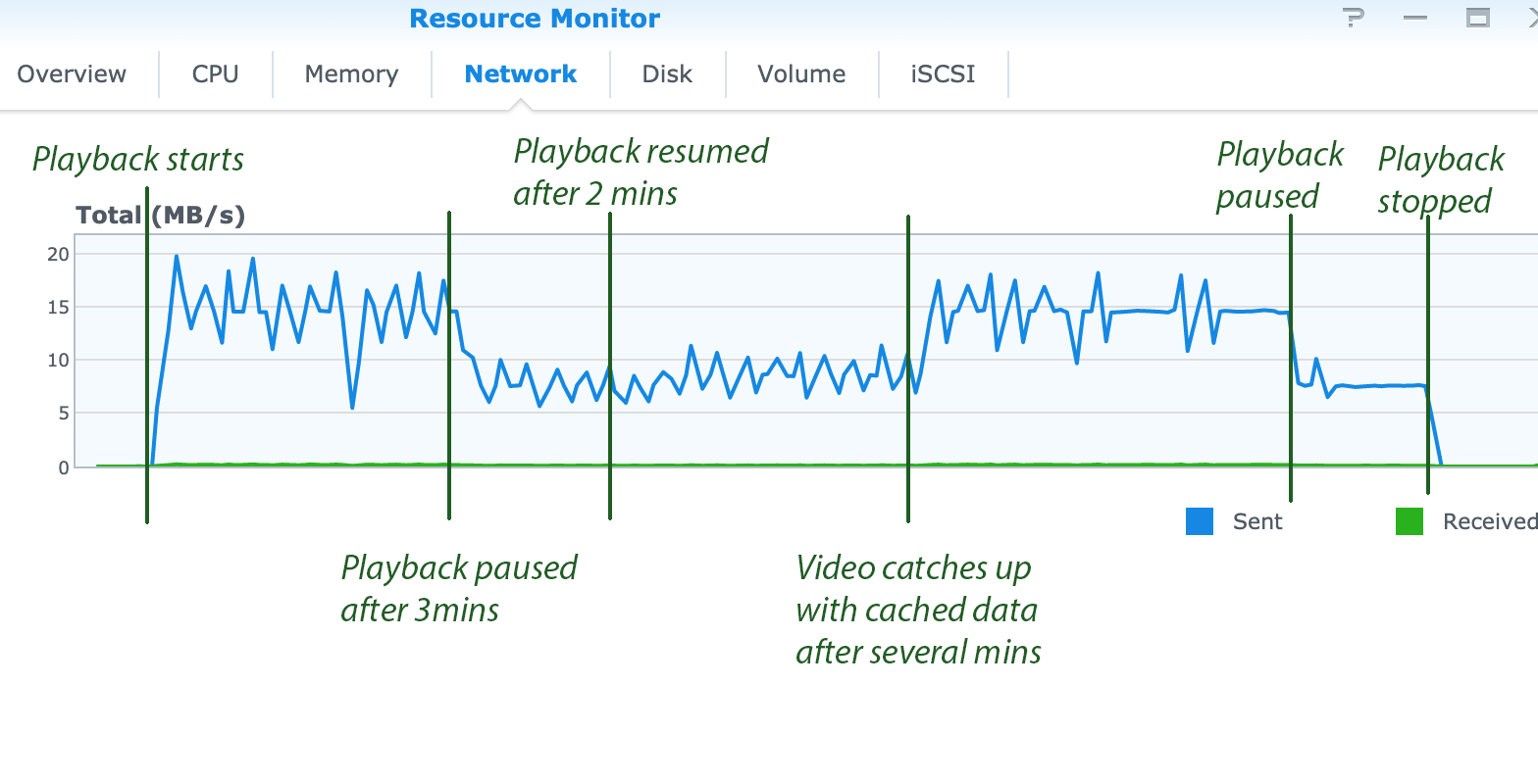

Anyway I did some analysis a month or so ago with the previous version of Infuse, and now I’ve done that again with the latest version of Infuse for comparison. What I did was play a test video, and check what the data transfer rate was from my NAS during play/pause.
No other devices were using the WIFI while I ran my tests.
So I have 2 graphs from my NAS, which I have attached here, one from before, and 1 after the Infuse update.
Points of note (remember, video = 15M Bytes/sec, available WIFI bandwidth > 30 MB/sec in my case):
  1. During normal playback, the video data transfers from the NAS at around 15 MBytes/sec, enough for playback but NOT enough to buffer ahead. The cache bar does NOT fill up.
  2. During pause, the video transfer rate drops to around 8 MBytes/sec. Well below the video bit rate.
  3. Data transfer peaks at around 20 MBytes/sec
    Because the video never caches ahead during playback, I believe that was why I was seeing the occasional buffering. A momentary drop in WIFI performance would be enough to cause it.

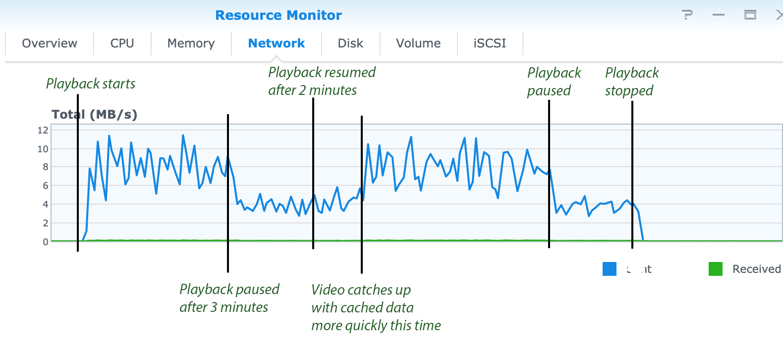

Fast forward to today:
  1. During normal playback, the video data transfers from the NAS at around 8 MBytes/sec, nowhere near enough for video playback. This seems to be the direct cause of the buffering after 10 seconds of playback.
  2. During pause, the video transfer rate drops to around 4 MBytes/sec. Well below the video bit rate, and about half of what I was seeing in the previous version of Infuse.
  3. Data transfer peaks at around 11 MBytes/sec.
It is my theory that Infuse is clamping the maximum WIFI data transfer rate, and the maximum value (which was already too low) has been essentially halved with the new version of Infuse. I believe this will also affect lower bitrate videos too, but the problem will obviously be much worse for higher bitrates.
If my theory is correct, I would really like to see an option in Infuse, so that the user can decide what to set this to because the value was already too low in the previous version of Infuse.
