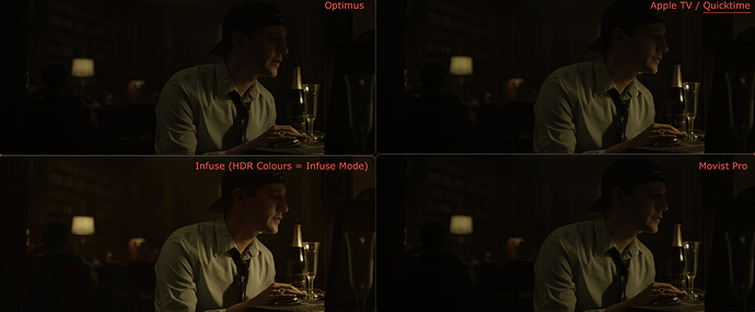

Hi, I’m new here and using Infuse 7.4.10. Here’s a screenshot illustrating the issue. I have more if needed. As mentioned above:
Inaccurate colours vs Quicktime, YouTube in Safari / Chromium, Movist Pro and Optimus. In all of these others the colours are identical but they appear incorrect / inaccurate for me in Infuse. This is while using “Apple” HDR Colours also. The “Infuse” HDR Colours are even more inaccurate in this regard.
Here’s another screenshot from The Social Network for good measure, this showing how it looks accurate in all other players bar Infuse, Quicktime / Apple TV App being the reference to pay attention to. Still using the “Apple” HDR Colours in Infuse. Hopefully I’m posting this in the right thread.
And finally here’s a screenshot with QuickTime / Apple TV still as the reference but now I’ve set Infuses HDR Colours to the “Infuse” setting instead of “Apple”. As you can see; both settings for HDR in Infuse are inaccurate and not correctly presenting the correct palette / creative intent.

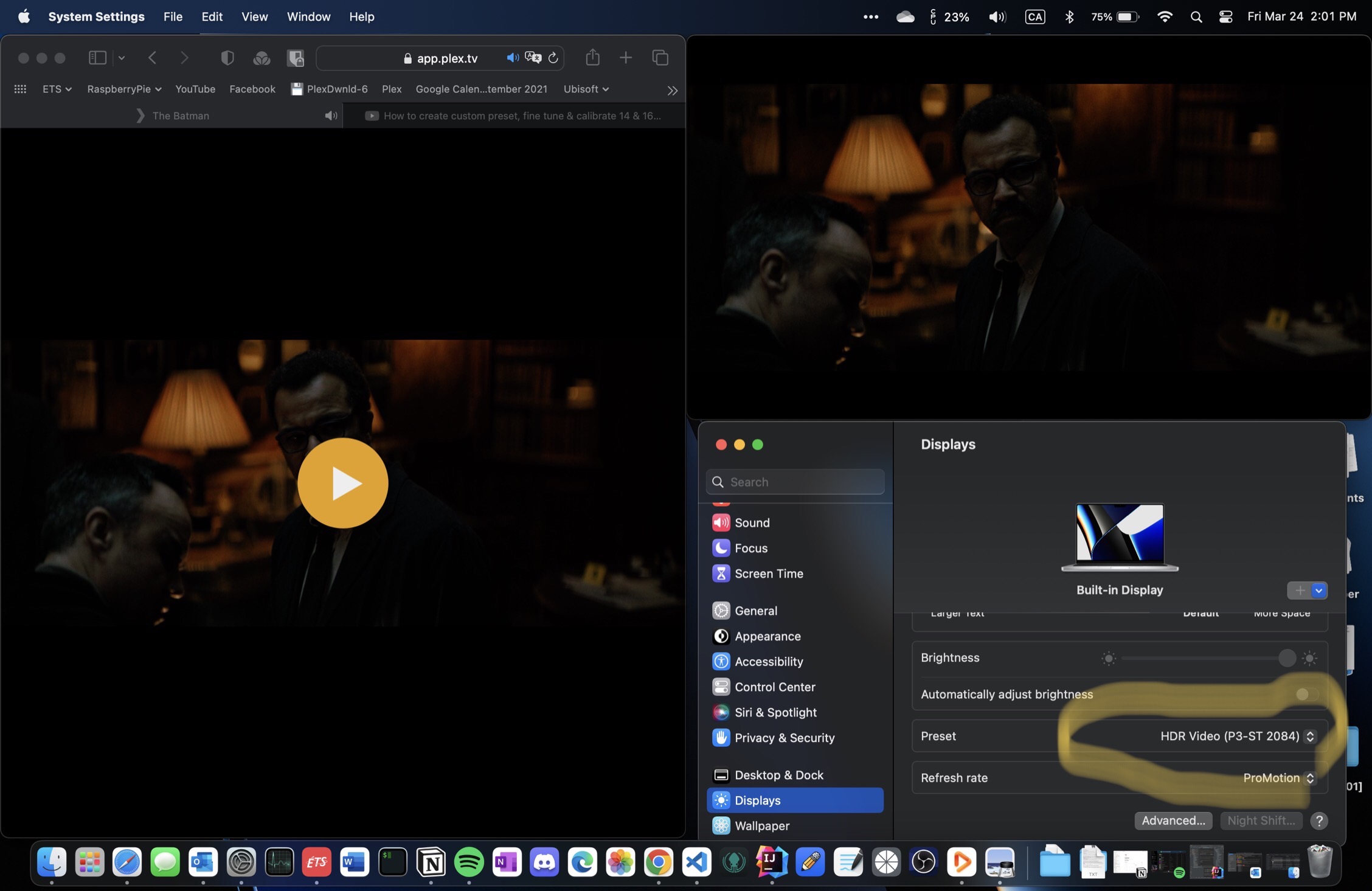

I just toggled between “P3-1600 nits” and “HDR video (P3-ST 2084)” display mode on my Macbook M1pro to see if it makes any difference.
To my surprise, Apple color pallet in “HDR video (P3-ST 2084)” mode is actually accurate and identical to Quicktime!
Additionally, “Infuse color pallet” also produce different results in “HDR video (P3-ST 2084)” and “P3-1600 nits”. It’s especially noticeable in dark scene.
So it looks like Infuse actually has bug that affect both Infuse & Apple color pallet in the default P3 display mode.
Hope this help Infuse team to identify the root cause.

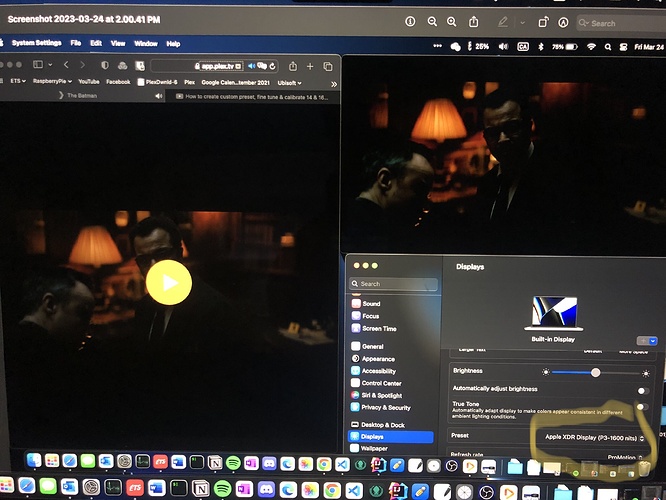

But I have noticed a strange behaviour when I look at my internal screenshots. If I look at them with another device or in P3-ST 2084, Infuse is unchanged between the display mode but Safari become like Infuse in P3-ST 2084 :
AFAIK, screenshot and screen recording in Mac is 8bit so the HDR/EDR shown on your macbook isn’t captured so it looks weird,
on top of that there isn’t a HDR photo format (like AVIF HDR, jpegxl, or the proprietary HDR-capable HEIF that only photos app support) that Mac support so even if apple upgrade screen capture to 10 bits, HDR still can’t be shown.
