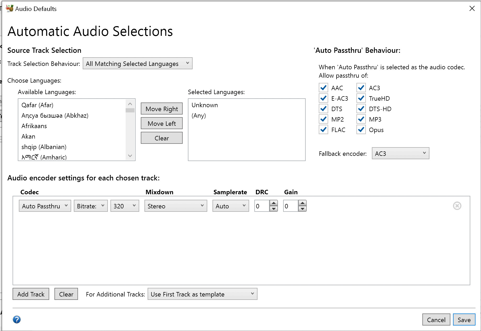

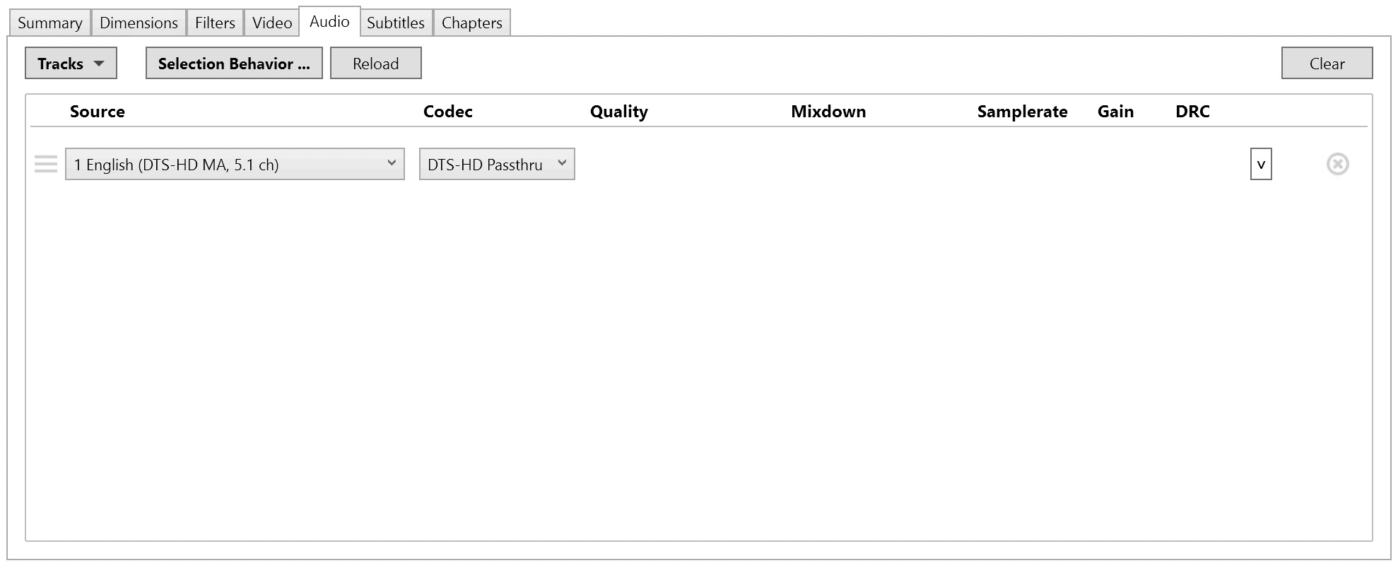

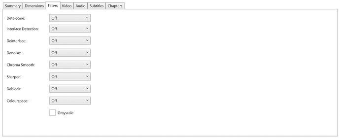

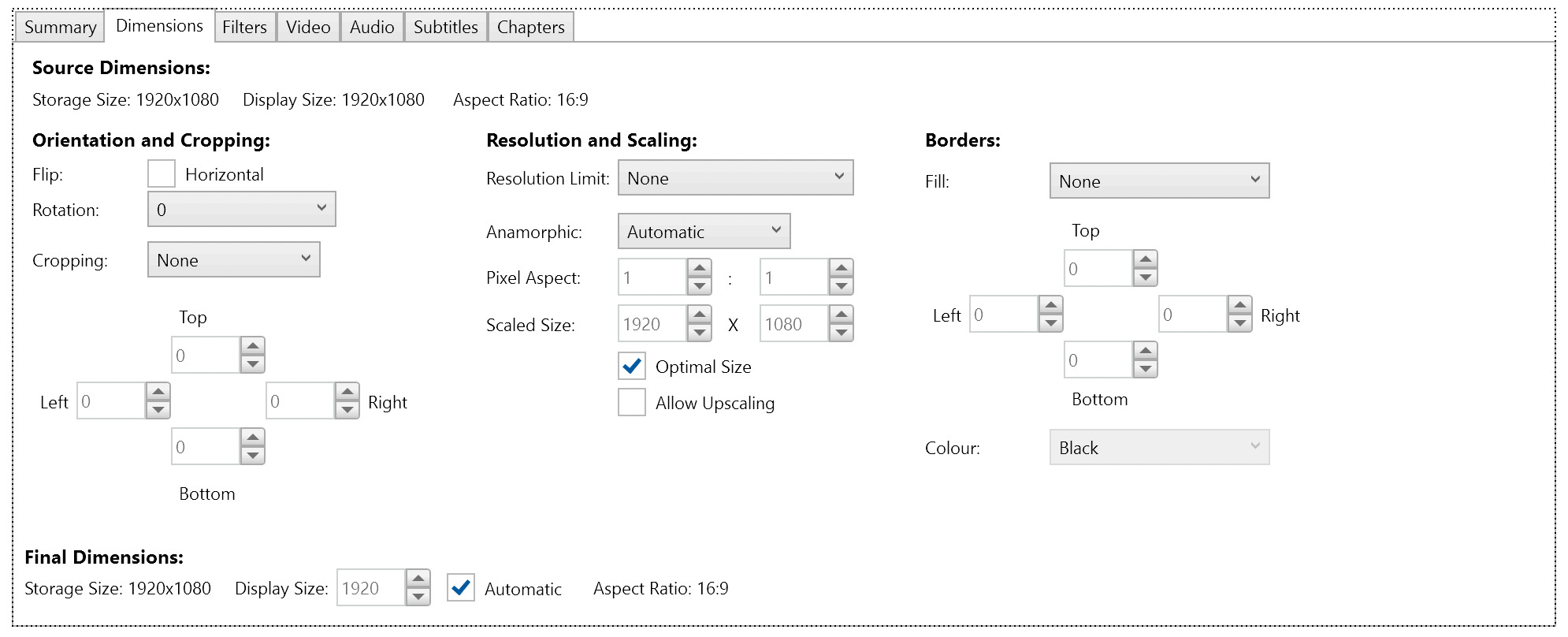

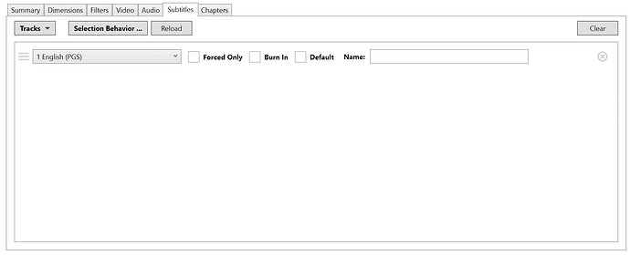

Here are all my settings from the various tabs (and luckily you can create a preset to default to these for you):
The most confusing part of creating a preset is defaulting to passthru for every kind of audio (except PCM, which for some reason Handbrake can’t passthru, so you have to give it something to transcode to, and I went with AC3 which is Dolby Digital):
That last option is “Auto Passthru” which passes through everything you checked at the upper right, but if it can’t passthru (PCM) then use the options after that (bitrate, mixdown, etc). In the few discs I’ve converted so far, I’ve only seen PCM as stereo tracks (commentary I’m guessing) so I set the default mixdown to Stereo.

I’d suggest to switch your fallback codec from AC3 at 320 kb/s to Opus at 192 kb/s for Stereo. Opus is hands down the best lossy audio codec and I’d go as far as to say you will not be able to tell it apart from the PCM track. It’s a minor thing but it will save you space (yes very little but if you transcode, why not do it the most efficient way) and provide higher quality than AC3. :slightly_smiling_face:
