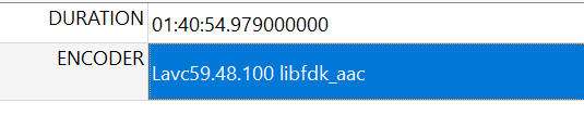

Several h.265 HEVC MKV files will play fine on the MacOS version of Infuse, but will only playback audio on the iOS and TvOS versions. On the iOS and TvOS versions, the screen is completely black while the audio is playing. Below is a copy of the encode parameters.
I was hoping todays 7.6 update would fix the black screen problem for h.265 files that is mentioned in the release notes. Sadly, it does not on iOS.
7.6 release notes
Fixed black screen for certain HEVC videos
You are now the 4th person I have seen with this issue and thanks to your screenshot it seems everyone with this issue has one thing in common.
The release group YTS.
As with the other guys who have posted a mediainfo it shows a colourspace of bt.709 which I’m pretty sure it shouldn’t be for 4K HDR/Dolby Vision content.
There seems to be something thing strange going on with how they encode their files.
Do you have any content from a different release group that has similar issues?
