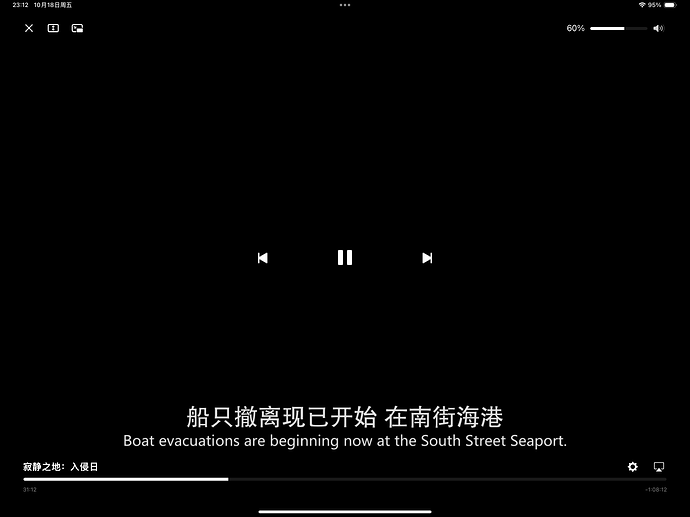

I’m using the latest infuse 8.0 release with iPad Pro 13-inch. I notice that when playing the local DV P8 file downloaded to iPad, I will get black screen with only audio and subtitles. Meanwhile when I streaming the same DV P8 file from NAS, everything seems working just as fine.
It seems that this situation only happens when play backing local DV P8 files. I also test play backing the local DV P5 files, it works without any issue.
I did the same test on iPhone and there is no issue playback local DV P8 file. So, I think the black screen issue only applies to iPad OS.

I have some new findings. Please see the video below:
1: Play DV P8 local file downloaded from NAS
The playback starts instantly. You will get black screen with normal audio and subtitles. Video can be seen in the preview window when skipping forward and backward.
2: Streaming DV P8 file from NAS
The playback buffers a little time and then starts. Everything works just fine.
It seems that in order to normally playback DV P8 file, a little buffer time should be added. Same issue happens on my iPhone 15 pro as well, sorry for the mislead in the previous post.
In addition to that, I also notice that sometime when my iPad’s wifi connection is strong, streaming DV P8 from NAS can also starts almost instantly. In that case, I will also get black screen just like the local file situation.

I have an iPad air 5, whenever i play a 4K video in infuse that have Dolby vision everything works right except the video itself there’s no signal it is pitch black, but if i turn Dolby vision off the video plays normal

I have a media file using Dolby Vision profile 8.1. The file plays fine on my AppleTV 4K (3rd gen, tvOS 18.1) using Infuse 8.0.3 but on a M4 iPad Pro (ipadOS 18.1.1) running Infuse 8.0.3, there’s no video. Seemed to be different than other issues I found here from searching, hence the new post.

Turning off “Dolby Vision” in the Infuse player settings (Advanced Options) allows the video to appear.

I have an M4 iPadPro (ipadOS 18.1.1) running Infuse Pro 8.0.5 > DV file runs as black screen with sound, but turning off DV from Advanced Settings in Infuse makes the movie/picture show up.
It still seems to be HDR, although not sure if it’s as vibrant as with DV turned on.

Hi everyone, i have the 2024 iPad Pro with “Tandem OLED” - I tried to play a 4K DV video, but the screen is black the entire time. When I try to scrub using the bar, the scenes show up at the bottom, but the screen is black.

I also have iPad Pro M4. The issue must be related to Dolby Atmos in MKV container. Every movie with DV Profile 8 and DTS track have played fine but when comes to MKV movie with DV Profile 8 and Atmos tracks it always results in black screen. I removed Atmos track in MKV Toolnix to test it and left only HEVC video with subtitles and voila - the movie played fine.
