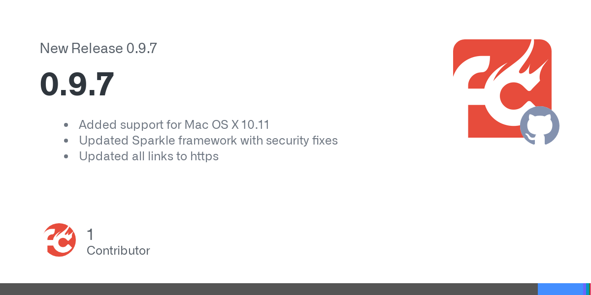

Beta: Seas0nPass 0.9.7 for ATV 6.2.1 and OS X 10.11
A new version with a handful of fixes hast just been posted. :wink:

I’m running El Capitan 10.11.1 and tried the latest Beta today (Oct 24th, 2015) and I’m also getting the File System Patches failed error.
me too the same problem!
ok I have now tried the last version of Yosemite and Beta: Seas0nPass 0.9.7 and it works … so I’m assuming that the Beta: 0.9.7 Seas0nPass has a problem with the current OSX version 10.11.1 (15B42)
