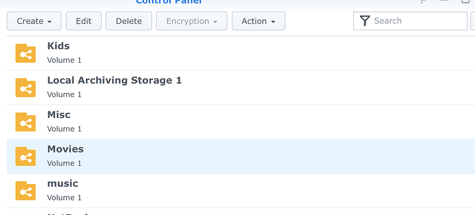

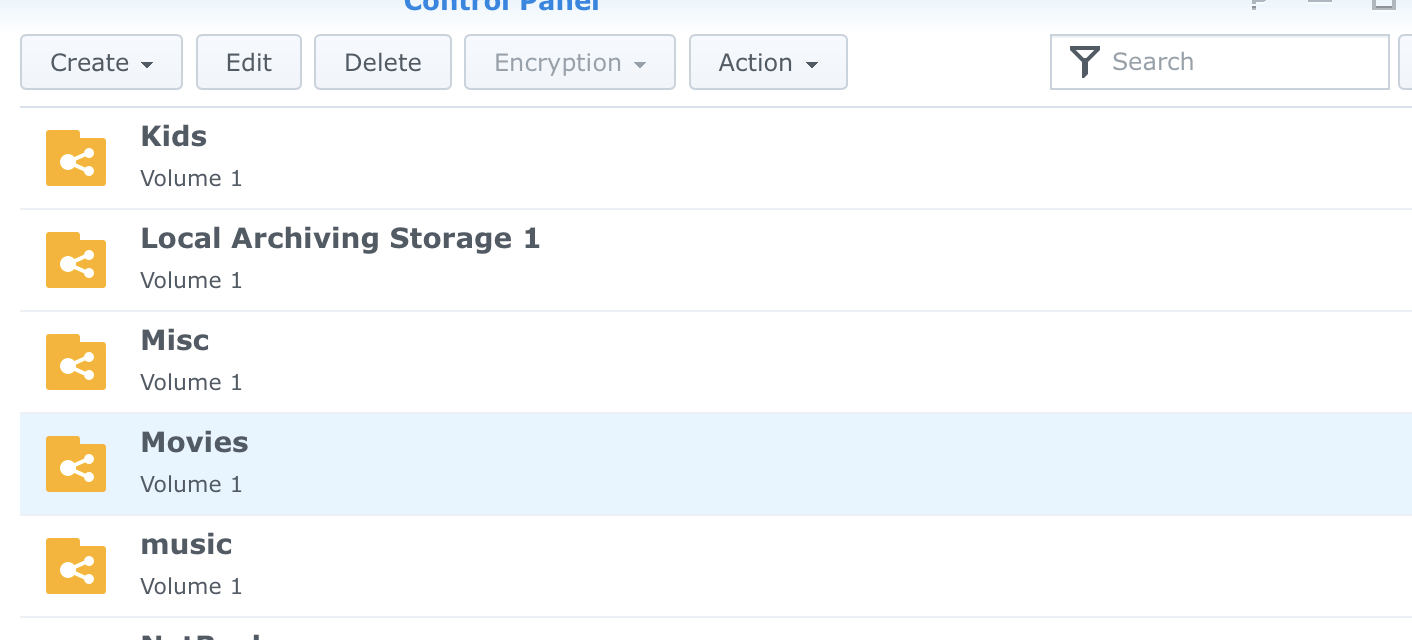

After enabling NFS, you’ll also need to add specific folders to share.
I have a Synology, so here are the steps for that device - others should be similar.
  1. Navigate to Control Panel > File Sharing > Shared Folder
  2. Highlight the folder you want to share via NFS
  3. Select Edit
  4. Under NFS Permissions select Create.

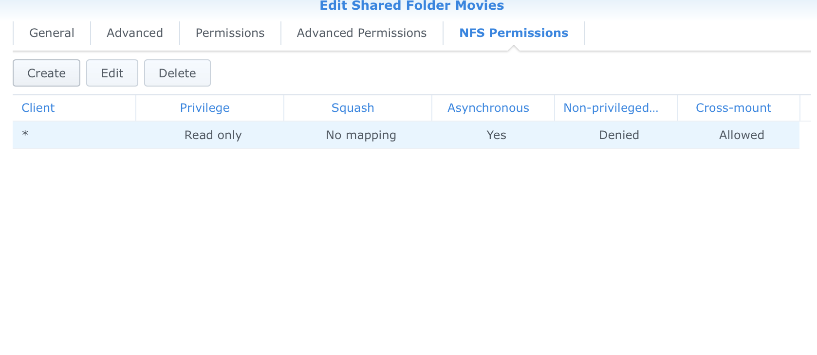

The attached screenshots may also help. :wink:
Thanks for the info! Are the settings in screenshot 2 the ones you’d recommend?
That’s what I’m using on mine, and it works well. However, depending on your network environment you may want to add some hostname limitations since NFS shares don’t require a username/password to log in. The settings in my screenshot basically allow anyone on your network to access the drive, read-only of course.
