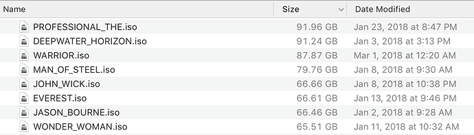

We’ve tested some pretty large files here (see attached), and Infuse handles them all very well. With regard to bitrate, Infuse on the ATV4K can handle up to about 200mbps, which is quite a bit beyond any commercial 4K films you will find.
Of course, the limiting factor with files this large is going to be the network, and having a wired Ethernet connection can make a big difference.
