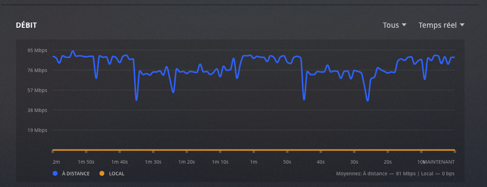

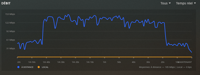

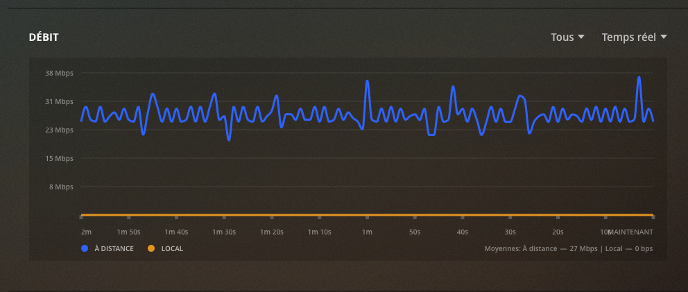

On the Plex side, I had to decide to watch bandwidth information when running a movie on my Apple TV or iPhone…
Two attached captures show the bandwidth used by two different devices.
For the same movies, we can see that the phone uses, on average, 80mpbs and that the Apple TV uses 30mpbs…
Can this “limitation” on the Apple TV side be the cause of my buffering?
